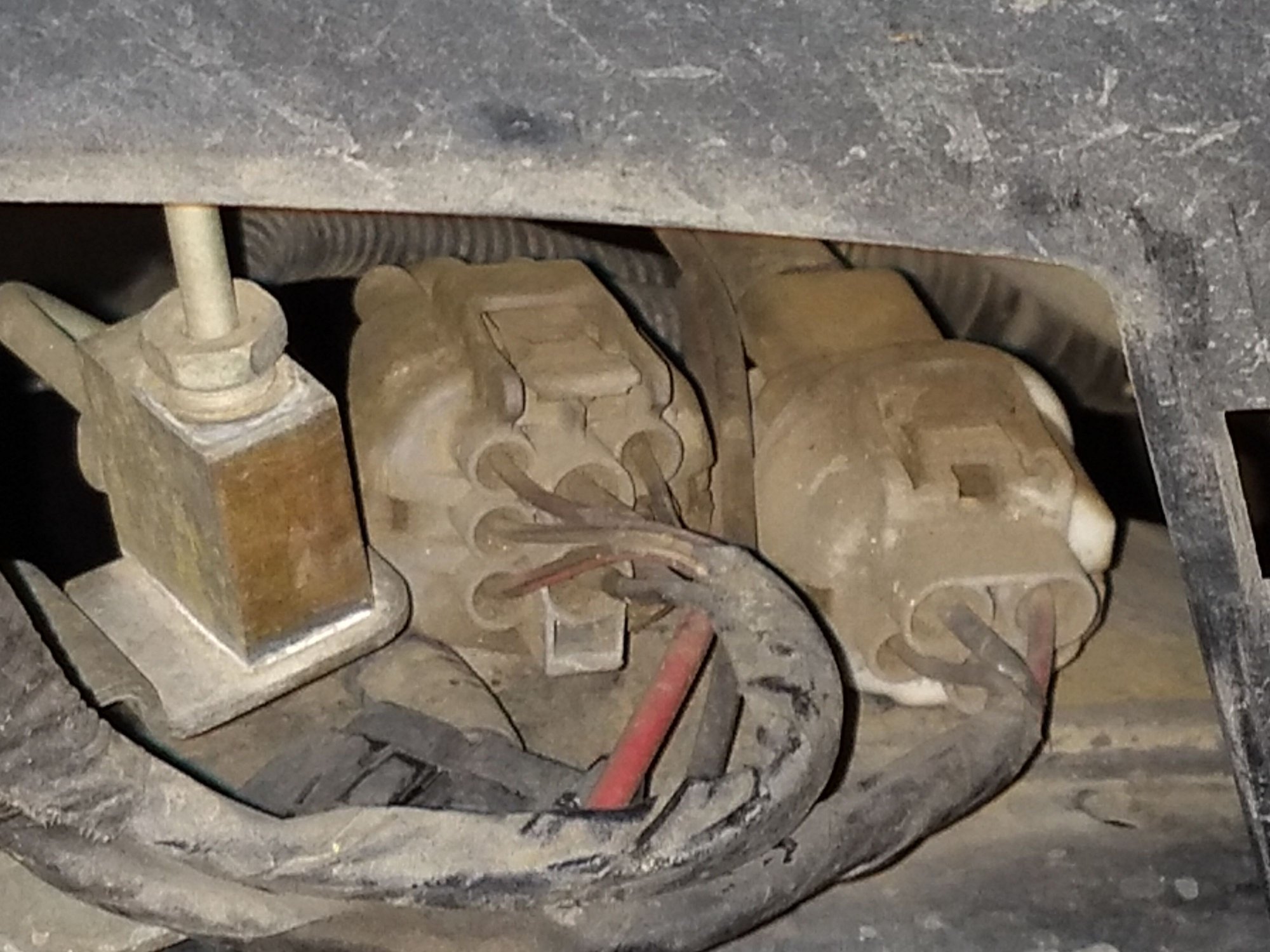

Are these the connections? This is on the front drivers frame rail, just under firewall

I didn't have time to open and clean out pins, but I sprayed electrical cleaner on these 3 connectors heavily last night, and this morning, there was no issues, no airbag warning. I think one or more of these connectors send the info to the cluster. (I have no schematics).
It was again foggy this am, and no issue. I will clean them out better and try to find the missing cover. Wish me luck, and THANKS!!!

That's actually not them, but those may be for 4-wheel ABS if your truck has that. Mine does not, and those connectors are not present.
Follow those ones to the right and under the fender. You'll see the 30 pin connector. I don't have a photo of it and the FSM drawing looks like a 3rd grader's.
This is as close as I have. The connector is right next to where the steel braided hose comes out from under the truck, on the outward side.
