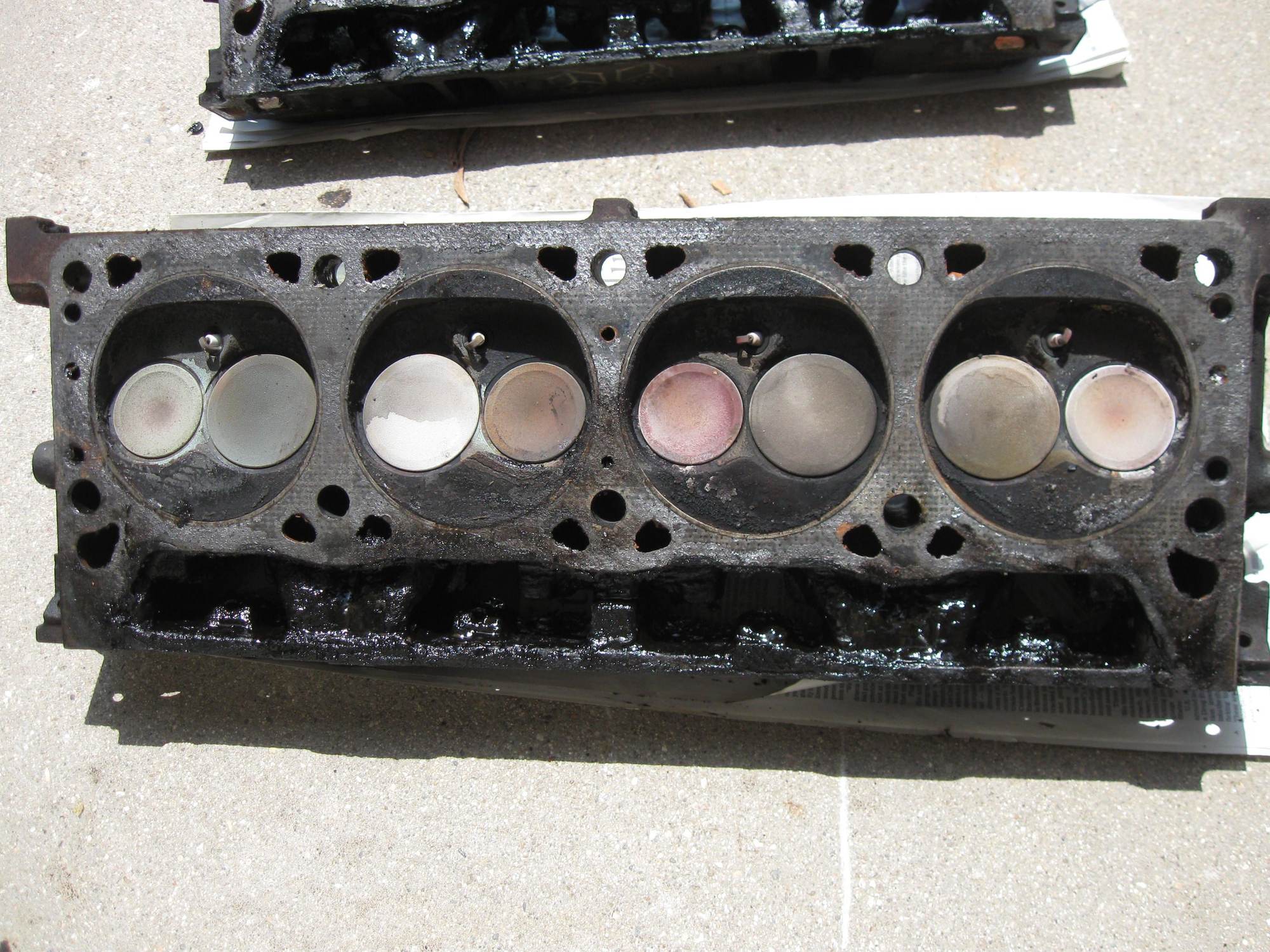

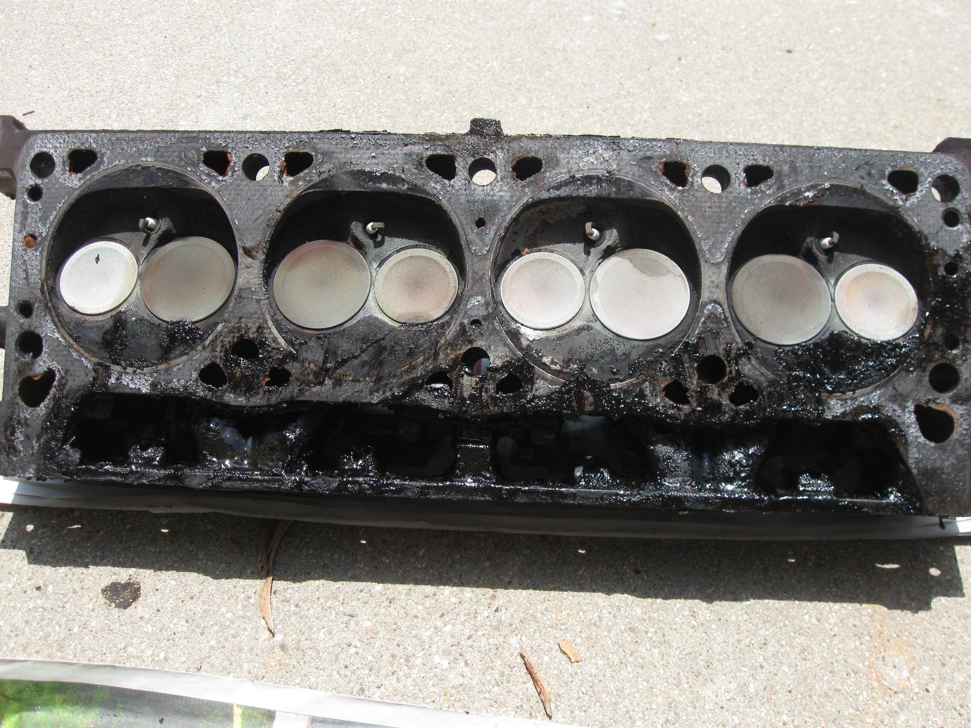

Can you post pics of the heads? (combustion chamber side please.)
Intake gaskets can also let coolant into the oil.

Combustion chamber side?

Sorry, tired not paying attention.
Drivers side
Passenger side
Old May 4, 2019 | 04:50 PM
  #27
Posts: 87,480
Couple chambers on the passenger side head look cleaner than I think they should. Not all the valves are uniform color either.... Is it due to a bad headgasket though??? I really couldn't say for sure.

What does the cleaner look mean? And if it's not the gasket it's due to cracked heads? I've see guys saying they go to scrap yards and pull the heads and see they are cracked. Where exactly do I look to see if there is a crack?
Cylinder #4 with the pink valve has been my problem child for a long time now, had ~110 compression while everyone else was at 135 or more, but that's been for 100k miles or so. Squirting oil in the chamber changed nothing. Was having P0304 misfire problems too, replaced the fuel injector that helped but the code did come up a few times since then.
I'm exhausted right now don't even feel like trying to take timing cover off. Maybe take a look at that tomorrow or later I feel energetic again. I'd really like to know where that coolant leak is coming from.
Thanks for your help.
Old May 4, 2019 | 05:48 PM
  #29
Posts: 87,480
Usually, the cylinders that are getting a bit of coolant will be cleaner, as they are basically being steam-cleaned when the coolant is flash-boiled by the combustion event. It's great for getting the carbon off of pistons and combustion chambers....

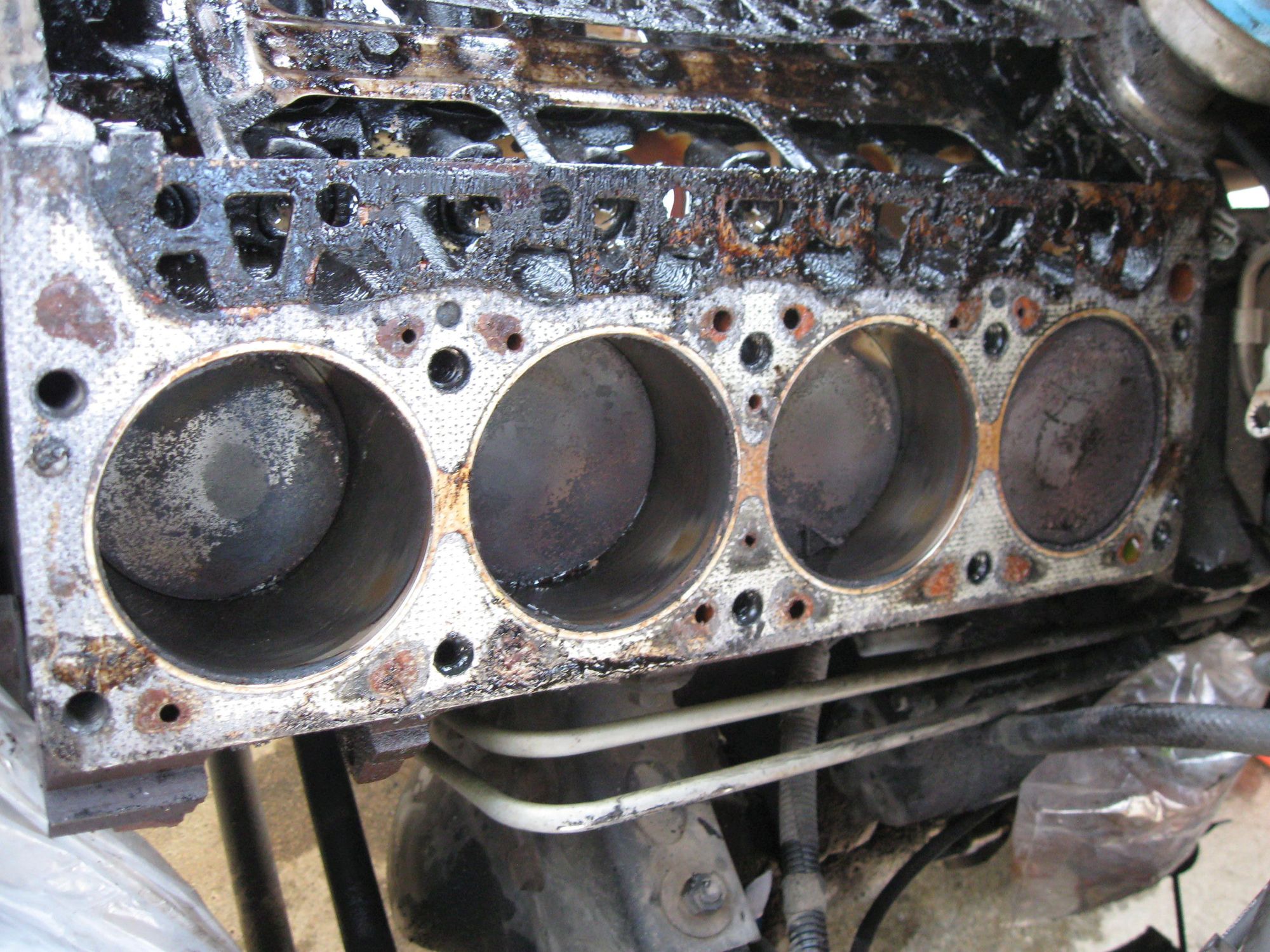

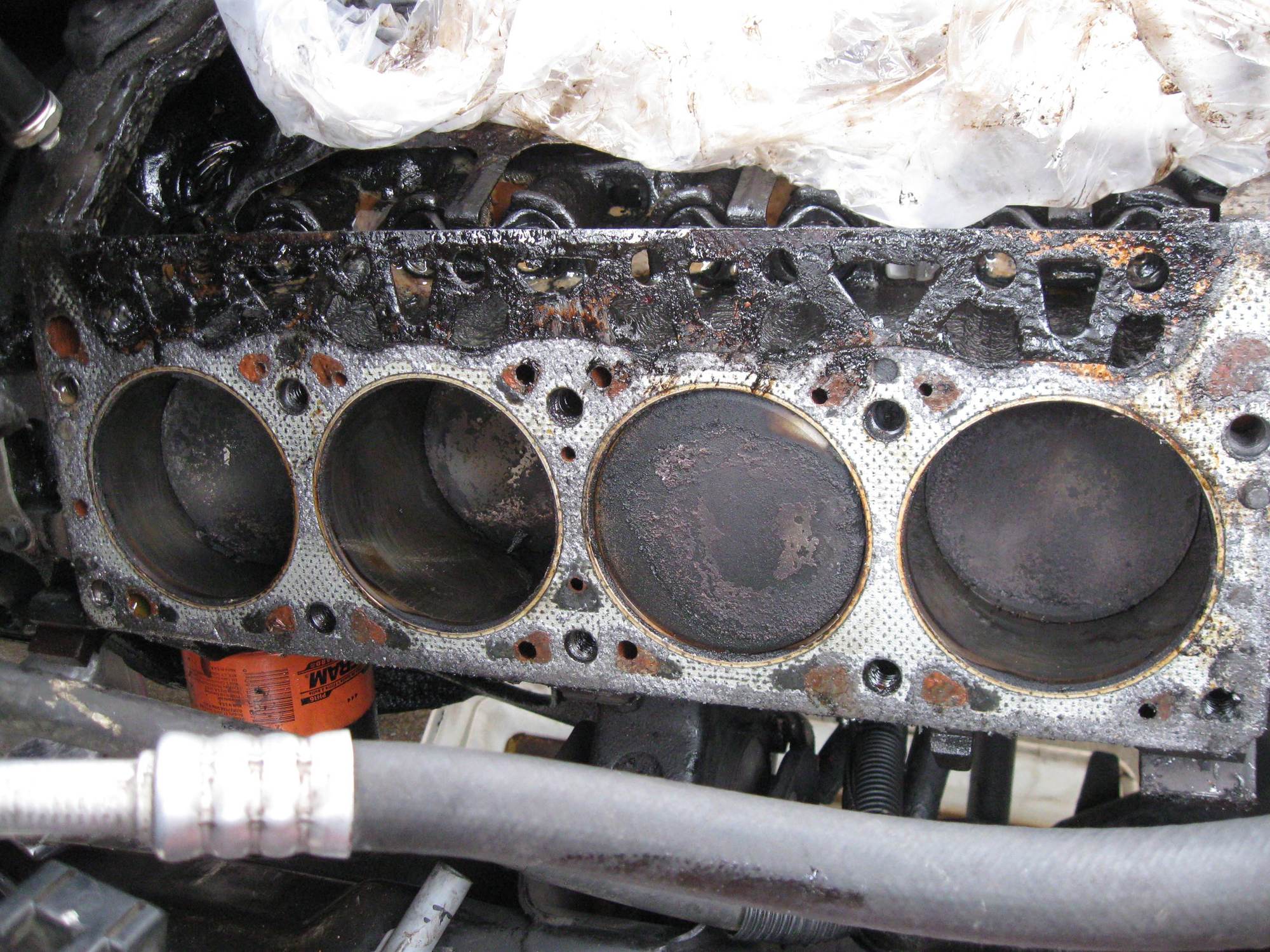

The crud inside the pistons is probably from having to move the heads around unnecessarily. They bolted the ATF fluid tube to the back on the head on the passenger side, and a ground strap on the drivers side. Didn't notice till I tried to remove them... those heads are heavy, especially when you arms are already sore and tired.
Drivers side pistons
Passenger side pistons
