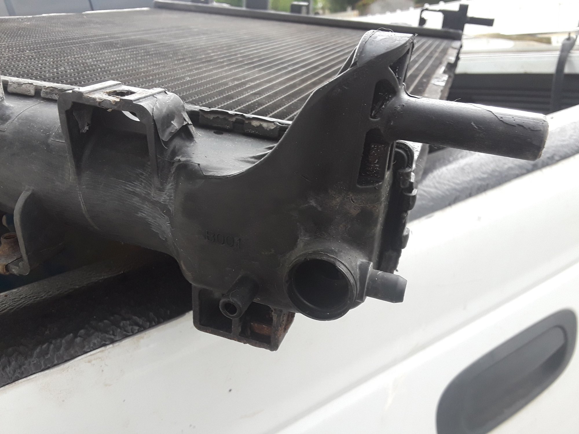

What is that 6-8 inch long small tubing on the bottom of the radiator close to the drain plug for?
It plugs into 2 places close together on radiator. .
Im going to replace mine since its kinked .
Thanks

Should have a petcock on the radiator, it's for draining it out.

I got that twistable drain plug .
So these 2 tiny rubber hoses are also for drainage?
Odd to have both..

I wouldn't know since mine has been frankensteined. but that is what would make sense, one coming off the factory 1/4 turn drain petcock at the bottom of the tank that was looped up out of harms way.

I guess your right ,i took a pic.
One end goes to same place as plug an the other just goes to a plugged end-inside that square to the lower left of drain..
