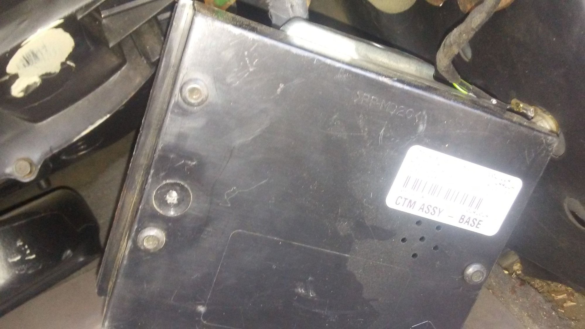

Default here a pic
says ctm on it..

That's looks to be factory. put it back in there.

It's factory alright. It's the CTM ....central timer module.

The CTM is the center timer module. It's what Chrysler calls their body control module. It's responsible for things like your alarm, key fobs, light controls, door locks, etc. I think they started using them on 99 or 00+. My 98, everything is controlled via the PCM.

Ah, yes. The early years had them up next to the glovebox. When the infinity audio was introduced, the CTM moved to driver side and the amplifier took it's spot.

thanks for the help..i velcro d it back in cense the bracket was broke
