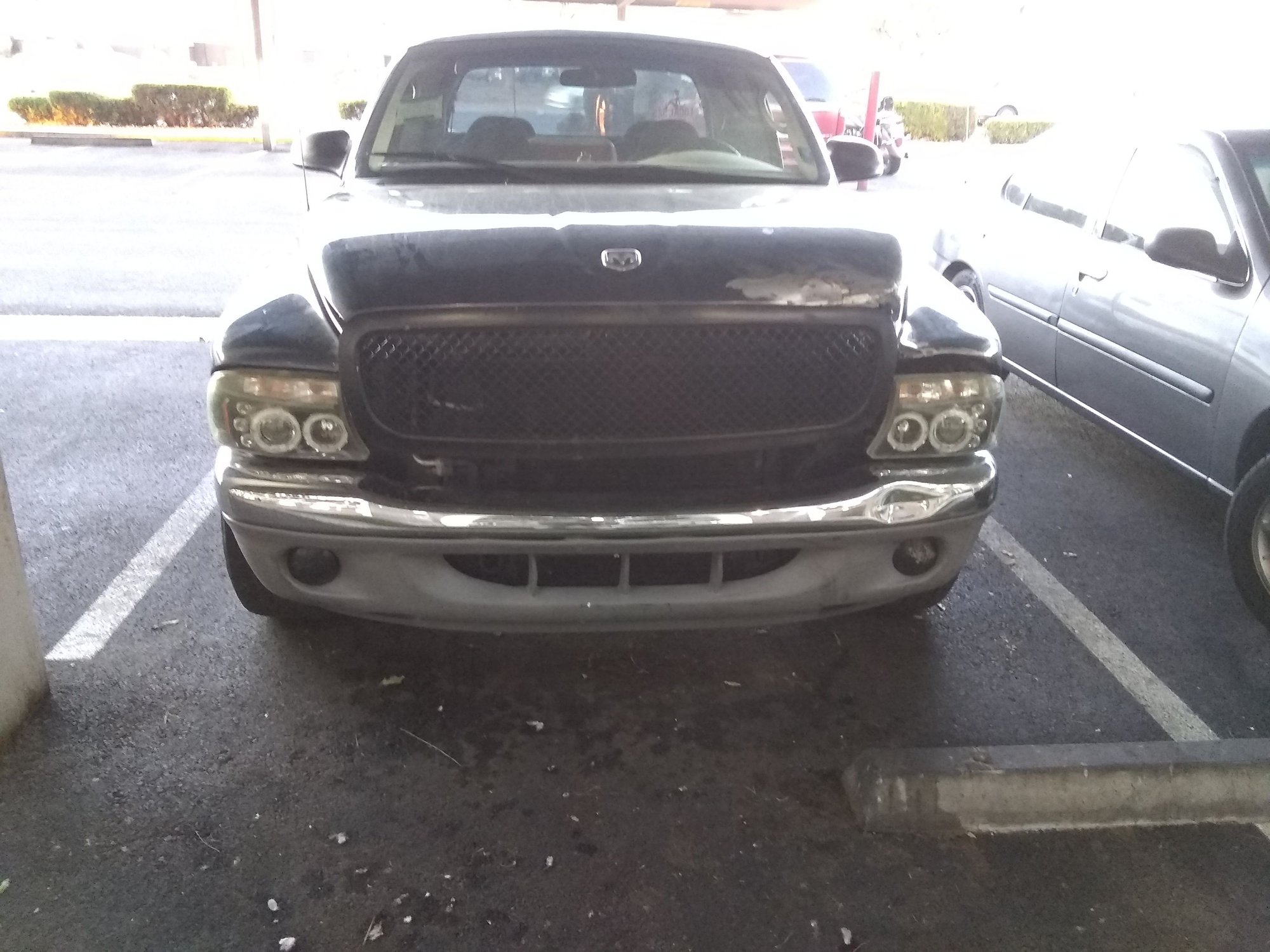

Before

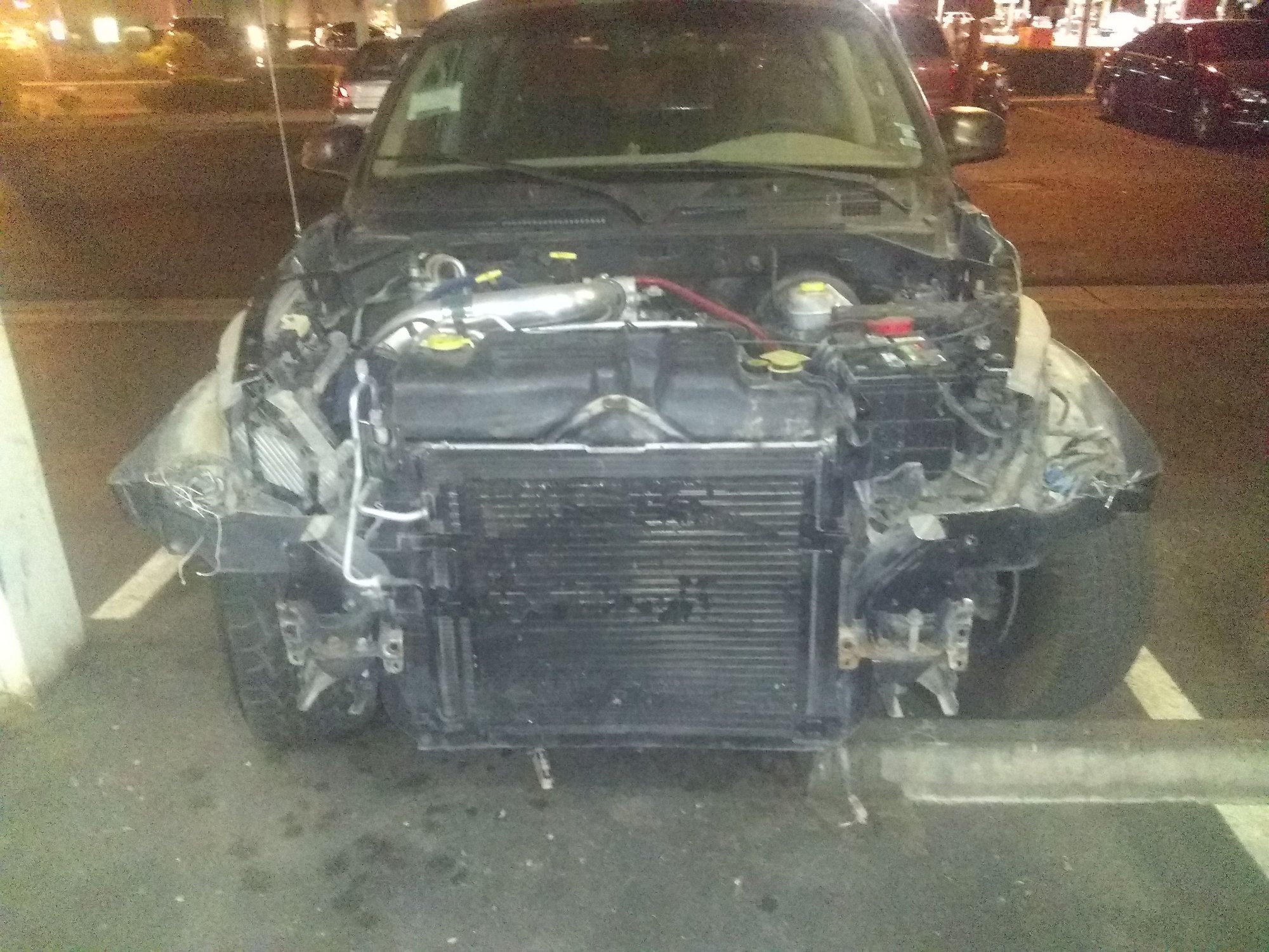

Demo frontend
Half way there

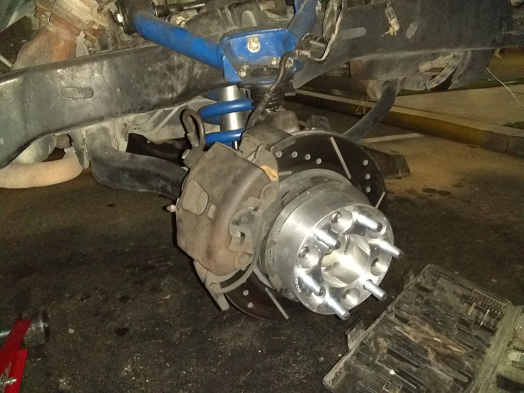

New brakes and rotors with 2\"spacers on each side

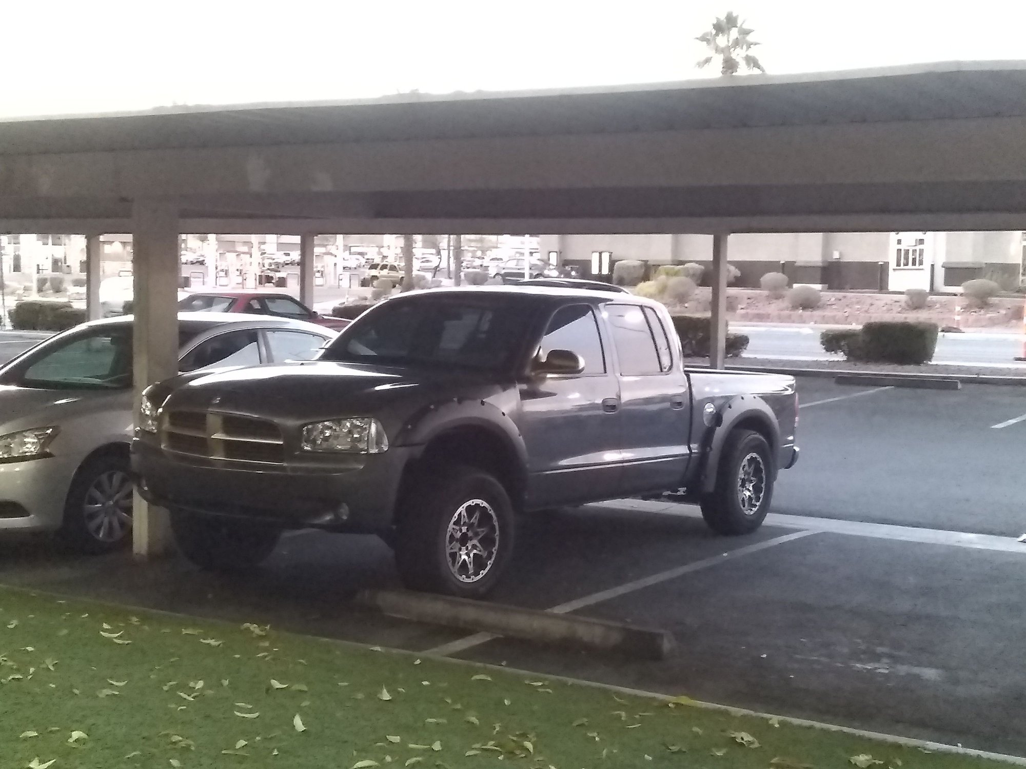

Complete
Done

how does it handle with the hub spacers/ wheel offset/scrub radius change?

Handles really good but never put the spacers on the rear end I snapped all the lugs off twice never doing that again I need to do an alignment I did the best I could but it needs to be done professionaly other than that I used to lose control of my back end when it rains but with the wider frontend it drifts like a trophy truck .

i used the front end off a 2010 charger hood right/left panels front bumper hood cut off right/left sub frame with the hood latches still intact and the front subframe for bumper and headlights check the truck out on tictok @Chargertruck
