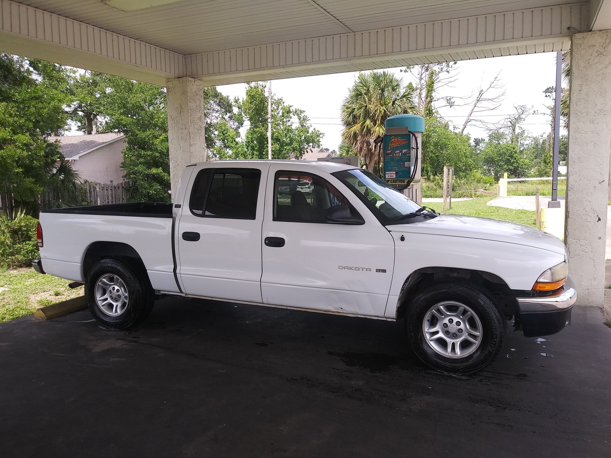

Hi folks, I'm new to this, a week ago I bought a 01 Dakota, and wondering if I regret it already. It's been three years since I had a vehicle and I've been on a bike. Today, the seat moved all the way back while driving and stayed stuck. And there's a box under the seat that's metal that gets so hot to the touch I burned my fingers on it earlier. Shifting & stalling out is Crazy. And a few other things. Did I make another bad choice as I did in the past on used cars? I REALLY needed this to work, I'm trying to get to my kids in
The '01 Dakota I've had for a week..
Indiana and I'm in the Florida Panhandle. Any and all help is extremely appreciated! Respectfully, Tod.. 850-704-7701.
