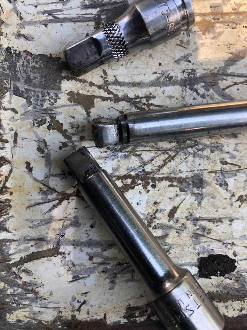

I've never been a fan of swivel adapters. I've got some and sometimes that's the only way to get a bolt, but they often get in a bind. Extensions are fairly cheap. I have a mix of various lengths. I've twisted a few through the years, I just replace them. Something that you might try is a wobble adapter.
Look at the end of the center one. Notice the taper? Snap the socket on all the way and it's just like a regular extension. Move it out a notch and you can get an angle. This is sometimes just enough to get a good purchase. Yes, it's weaker, but it still might be what you need. I'm not afraid to use a cheater pipe on my ratchets. I have one for my weight equalizing hitch and it fits just fine. That extra leverage may make a difference. Now, you might see if you can get a box end wrench on from the side. Either straight or drop end. I've done that and hammered it on the end to break bolts loose. A small part of a turn is all you need to get the bolt going. There's a lot of different ways to go for it and I'm not looking at the starter so I'm just throwing out ideas here.
