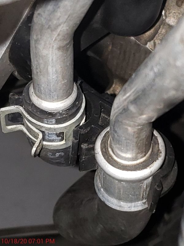

Spent the evening replacing some heater hoses, which I found were leaking after I pressure tested the cooling system a few weeks back. The main culprit was a hose I had installed with worm clamps five years back, after one of the OEM crimps started leaking. This time I did it right, using spring clamps. Worm clams suck. Don't use them anywhere if you can avoid it because they eventually fail. They don't adjust with temp expansion/contraction like spring clamps do, so they eventually crush the hose. If you use them around plastic, such as radiator necks, they will eventually crack the plastic.
This was the initial leak back in the day. If you look closely, you can see the coolant pooling on the left hose crimp.
Today's repair. This is down low on the block, near the tensioner. Pulled out the air box for some space to work.

I've never had a spring clamp fail. Screw clamps loosen up after a while because the hose and what they're clamped on expand and contract. That's why they bite into the hoses after a while cause there is no give. I got tired of having to retighten. My spring clamp tool is a simple pair of pliers. Didn't even know about the special tool.

I've found that the aftermarket hose that I used is not as thick as the mopar hose, so that circumference difference affects the spring's clamping ability. Also, the spring clamps have slight size differences.
I have a bag of them that I pulled off at the junkyard and took the time sizing up with the hose till I found some small enough to work. Some I could stick the 5/8 hose thru like a loose wedding band.
