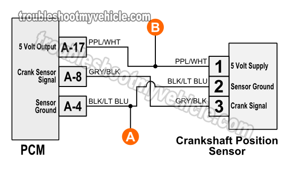

This may help .I'll try to get the full diagram but it's a start.
Is on 97-99 .

I'd do a ohms test from the A4 at pcm to the # 2 ground or that black/ LTE bl [middle wire]ground at the harness
[see diagram].
An the same test with the other 2 wires to rule those connections out too.
An wiggle the wire a tad when connected on ohms test to see if theres a break in the wiring too.
