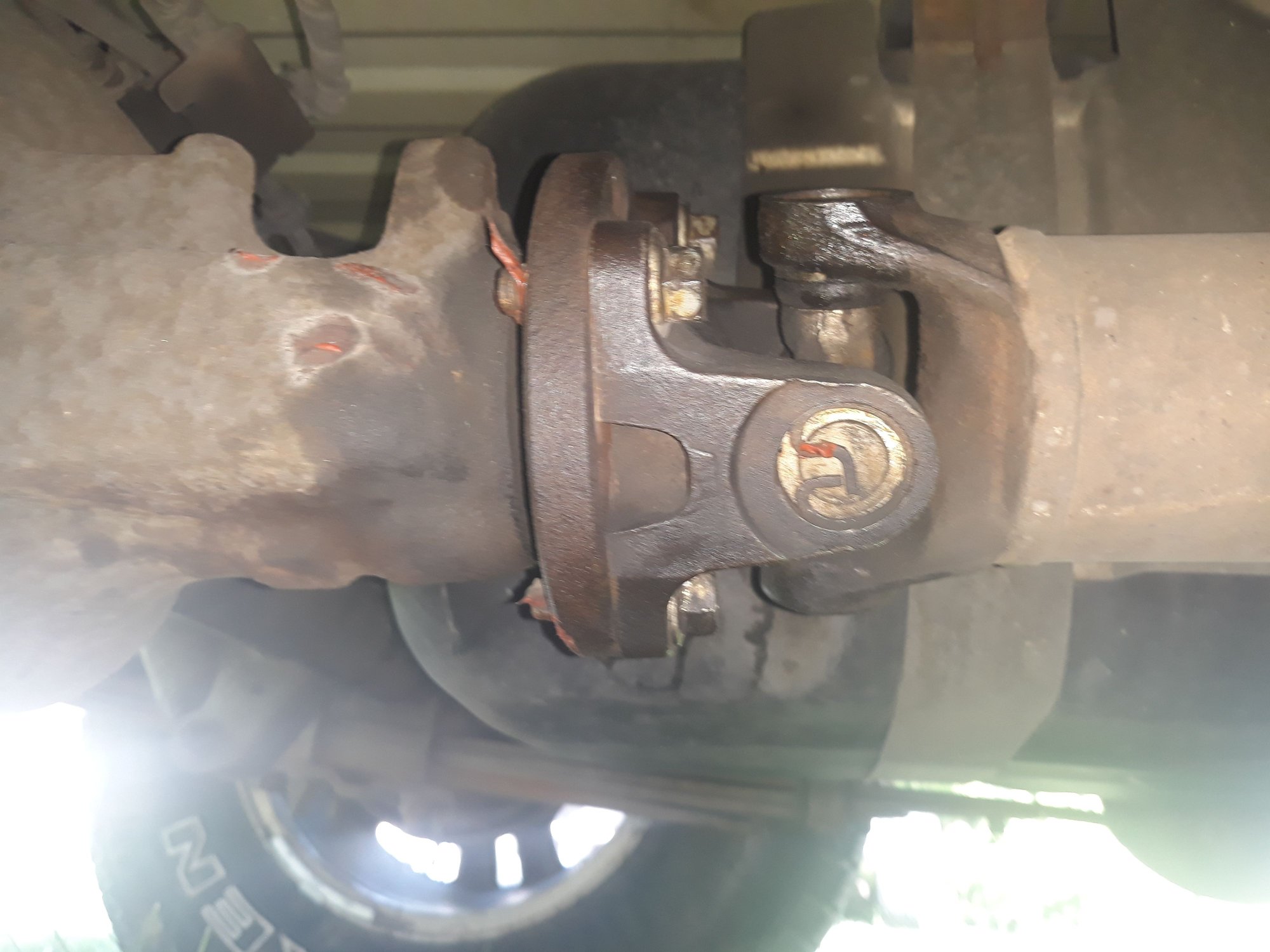

You got a pic?
What do I need to do to get it off?
Old Sep 7, 2021 | 11:22 AM
  #26
Posts: 87,483
Your pic. That's the carrier there. Need to pull the axles, then those four bolts and out it comes. Bearings are under the caps.

So are the blue arrows pointing to the pinion bearings.Is the carrier way up in the front red arrow where the entire differential gears gotta come out to get to it? Crazy design .
can you post a pic of one...
Old Sep 8, 2021 | 08:41 AM
  #28
Posts: 87,483
Blue arrows are the carrier bearing caps. Pinion is what provides power to the ring gear. (the driveshaft attaches to it) Carrier is what you see there with all the gears.
