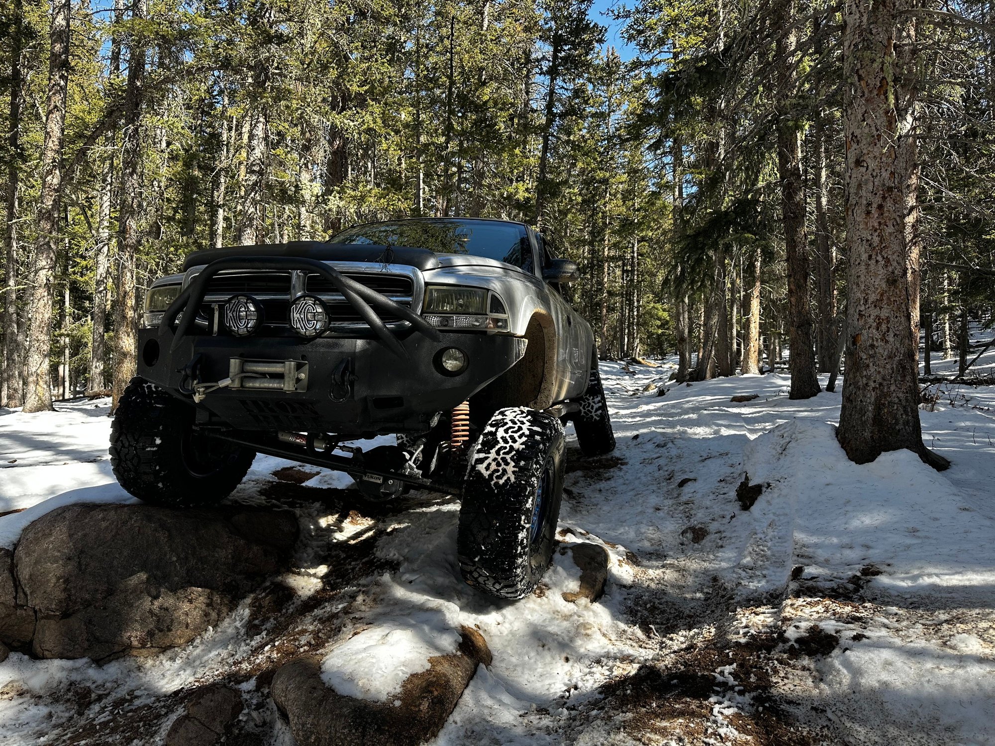

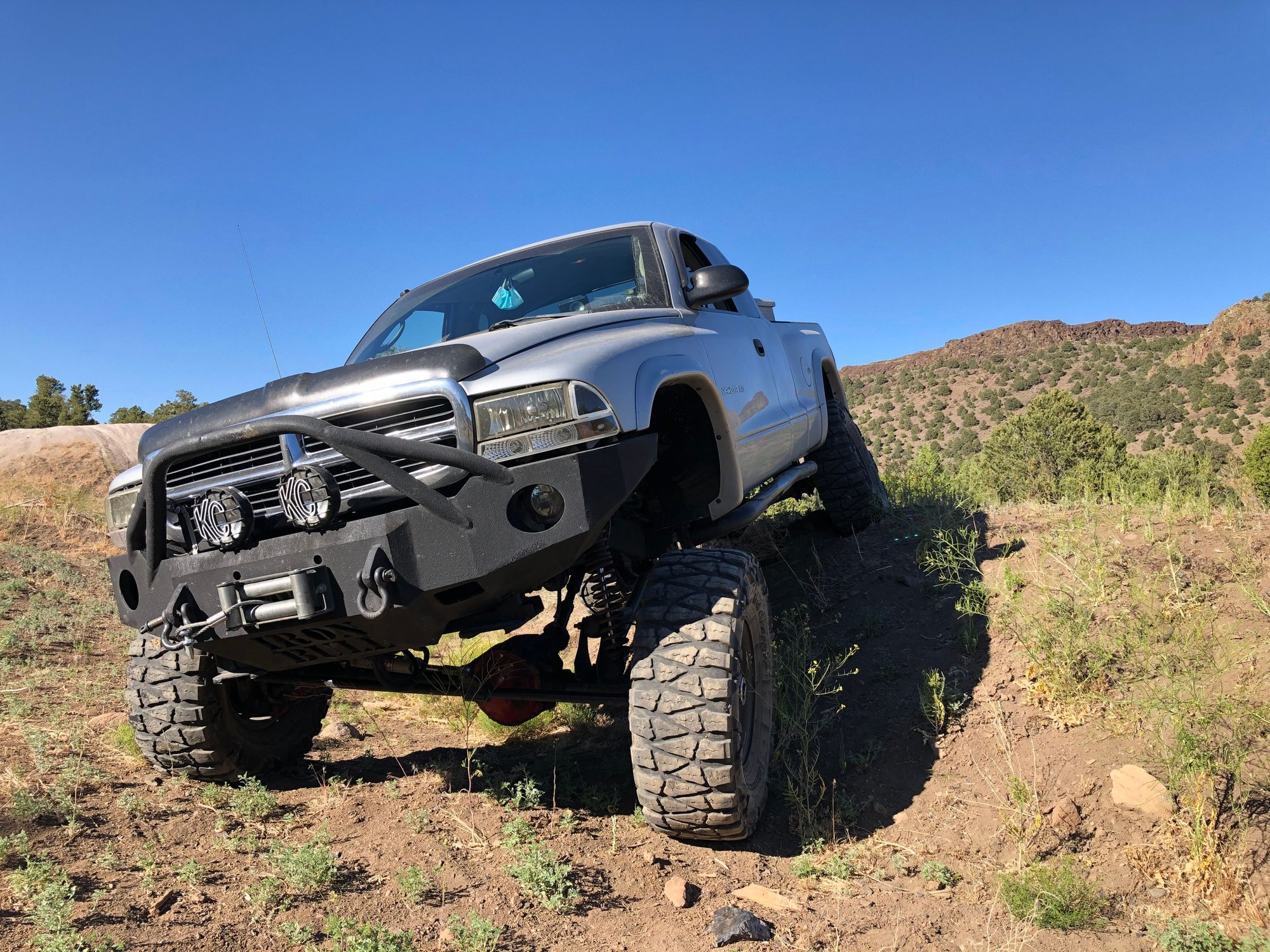

Steve,
First, great write up man. Way to pioneer getting this information and helping the community.
I am intrigued by a few of your mods and will be starting to explore these on my 2002 Dakota 4.7 manual 5-speed.
I recently swapped in a new 4.7 and added the HO cams and 2008+ (think I snagged mine off a 2012 jeep) intake (slightly shorter runners than the previous HO intake on the 2002-2007 HOs).
My current MODs are:
JBA headers (have been installed for... 6+ years now maybe closer to 8)
True dual exhaust with the 3rd CAT/CARB deleted (still passes smog, completed in 2011/12)
Air Raid CAI (installed since I bought the truck in 2008)
HO CAMs and 2008+ intake (June 2024)
SAS Dana 44 HP (eaton locker and manual hubs) and Dana 60 rear (yukon air locker) (2010)
5.13 gears (2010)
35" tires (used to be on 37s)
I average about 11-12 MPGs which makes sense due to the added weight, gears, and larger tires but I was hopping to get some back with the new engine and cams. Based on your write-up I should be looking at adding the intake wind turning vane (need to figure out how to make one), adding a longer pickup/forced air port onto my intake box and running it to the grill some place, maybe some newer injectors (I tried this with some other 12-pin injectors but the truck ran worse and very rich), a tuner (tried reaching out to Nick at AirRam but haven't heard back), and maybe these potato launchers (great name by the way).
What are your general thoughts? Really wanting to gain whatever I can in MPGs. I feel most my power in the 2800+ RPM range but that is not to say that I have lots of low end torque with the gears. Currently, at highway speeds of say 70mph I am at about 3000 rpms (wish I had a 6th gear).
-Marshall

farris42's Avatar
farris42
Joined: Dec 2011
Posts: 11
Some serious customization going on there. Pretty deep gearing for the tire size though???
Nice Truck.
Haha, thanks man! It has definitely been a fun project. Started with leaf's upfront, then swapped to the coils (should have listened and just started with them). The gearing was a back and forth. Started with 4.10s on the 37s, but 5th gear was non-existent. Chatted with an off-road guru and landed on the 5.13s (recommended for most manuals with room to run 37s). Honestly, it runs fantastic with those gears, even on the 35s. An extra top end gear on the trans would be ideal but for what it has, I honestly cannot complain.
