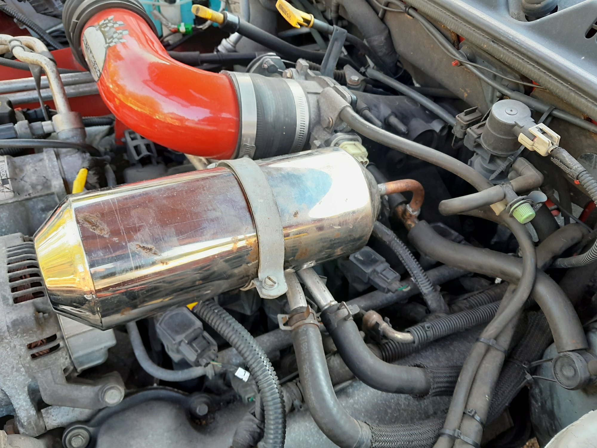

Originally Posted by V8Cowboy
Well finally some news, the HO engine isn't going to happen, seller wanted more when i told him i was interested....
Made a propper "Potato Launcher" Steve, and i'm impressed, should have done this way earlier.
I had a kind of Turbo lag with the Jeep TCM, now it's gone, pulls more evenly without hestitation through all the rpm's, so very satisfied with it.
Only have it done this past weekend, so no results for fuel economy yet, but i'll keep you guys informed.
my "PotatoLauncher"
that is a big canister and might be too big. What I have found is adding too much causes too much of a loss in the upper end. Adding back that ball valve gets it back and allows you to shift the torque peak up the rpms to where you want it.
For reference, google tells me my PLs are:
15.0" x 1.5" PL = 26.5 CI,
12.0" x 1.5" = 21.2 CI,
22" x 0.75" =9.7 CI
for a total of approx 57 CI. On my setup with the ball valve I'm able to choke down the flow in & out of the 12" PL which allows the shift in the torque peak. The 15 x 1.5" is always connected, the 22 x 0.75" is always connected & the 12" one has the ball valve on it.
Also, keep in mind I have the '03 intake manifold that has shorter runners which will also shift power up the rpms some.
