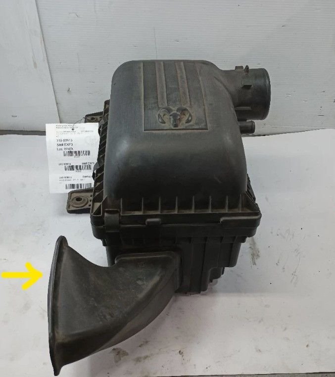

Had an idea recently that I am gonna see if I can implement this weekend... the output of the air filter box, I suspect there is an area where the airflow merges that is causing some turbulence. going to make & add a divider between the pleats where it enters the intake tube & eval the performance.
ON the air box, below is a crude drawing I did yesterday to post in another thread, adding it here for the next guy.
Reminder the air box is open 100% on both ends.

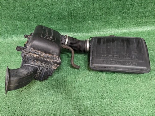

Steve, I'm trying to understand where air would collide? I don't have the airbox in front of me, but as far as I can remember, there is one intake sucking air in from the passenger wheel well, then one output to the throttle body and small hose or two. All the air is flowing in one direction up into and out of the filter. If anything I'm thinking dividing the output would introduce turbulence? I'm sure you've thought this out, so just trying to understand.

The box is open on both ends, I cut out both ends so there was no obstruction & the flow from both sides goes up the sheet metel into the filter. I tried the thought I had today and on the test drive, dont see any change so that mod appears to not be a good one. I dont see anything negative, just nothing positive.
pics of the upper air box mod for reference...
Going to leave it in and let the ecu adjust fuel trims if there is anything there. I'd seen in the past where a mod I did on this motor was "eh" when the install was done but "woke up" some after fuel trims at time to adjust. I dont expect anything from it but I have been surprised before.
If I were to make this a permanent mod, I'd switch it over to a piece of sheet metal since this piece is so thick. Time will tell & will update in about a week. I'm actually at work next week and not on business travel so it'll get a weeks worth of commute miles.
Edit... after looking at the pic of the lower air box, I noticed the sheet metal is bent up, need to fix that.
One issue I see is that you've eliminated the air horn, which bends around into the fender and sucks colder air from the wheel well. So now you're sucking hot air.

In the 4 years I have been monitoring the obd system, air box horn or not, the air temps always creep up. I do have a piece of plastic blocking some direct airflow from the engine side of the compartment to the air box and the front deflector by the radiator removed.
Also, when I wrapped the coolant lines & the intake tube, temps did drop. I did not log by how much though, it was in the 7~10* range.
