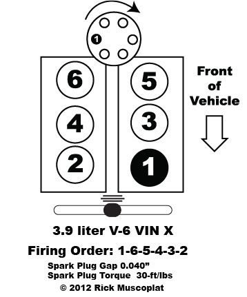

does your distributor look like this one at the bottom of the shaft?
If Yes then do this (again if needed)
1) rotate the crank to the TDC mark is aligned with the marker
2) pull the DS valve cover and verify both valves are closed
if not then rotate crank 360*, both valves should be closed
if both valves are never closed with the crank at TDC then the cam timing is not correct (not likely unless the timing chain was removed)
3) pull the cap on the distributor and verify it is pointing at the #1 contact
if not then pull distributor, rotate 180* and re-install so that it is. (It looks like it can only go 1 of 2 ways)
