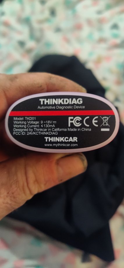

Hey guys so check this out, i knew i had to sync my injectors but no matter what i did i just couldn't even get it close, so i was debating, take it to a dealership or buy the snap on scanner, either way looked to be expensive so last night i was on Amazon looking around and came across a Bluetooth obd2 scan tool and reading through the info on it it said something about injectors pulse so i gambled and bought it..... Little over $100 bucks but guess what, it worked, under special functions wasa setting for injectors sync tapped on it and bam, instantly my truck smoothed right out, no more poping through intake no backfire, idles nice gas smell gone no stalling i mean it was like someone waved a magic wand. If i can I'll upload a pic of it but it's called thinkdiag it claimed to have manufacturer software and even claims to flash pcms so if anyone is interested I'd definitely look into it

What software did it come with?? PC? Android? iPhone???

I downloaded the thinkdiag app from Google play I'm sure it has an apple app but not sure if pc. Possibly though
