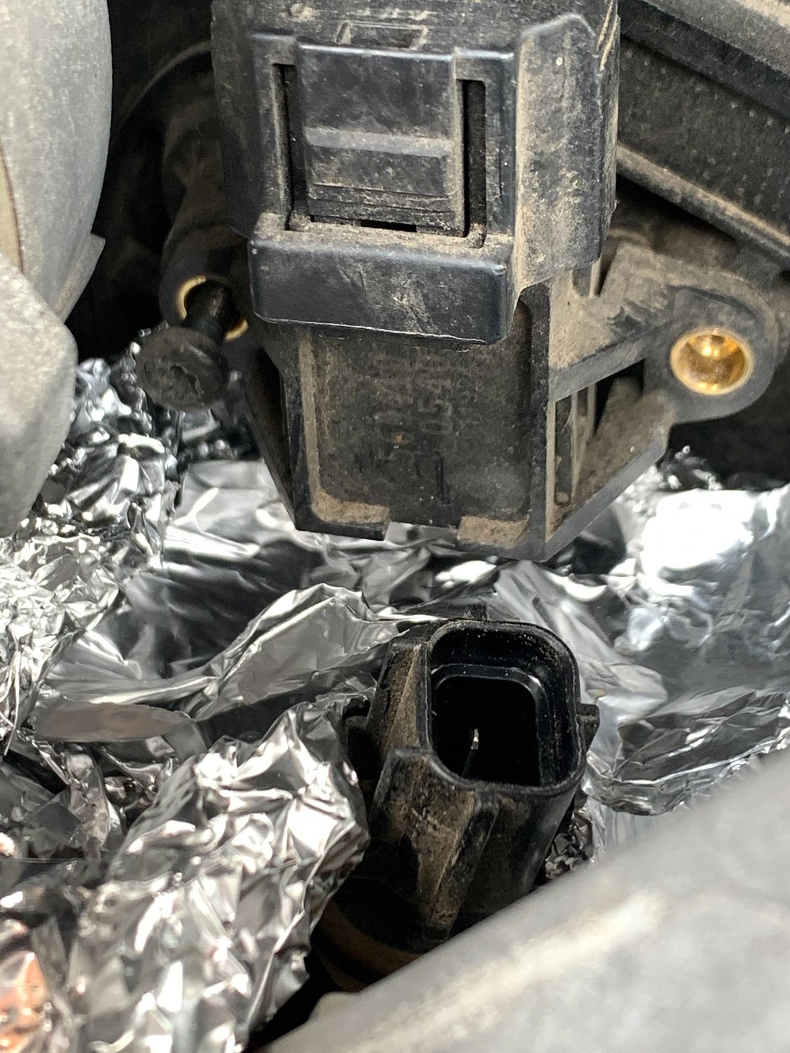

Those screws on the map sensor are a bitch to get out lol. The screwdriver is angled and such a small torx bit you don't want to strip them. I always watch a video before I do something, even if I know how. I'm so glad I did, the guy was working on a Dakota and he recommended using foil to catch the screws if you dropped them. Yeah, I looked and if you dropped them you would be screwed lol. Just a genius move because, the screwdriver, being at an angle like that in such a tight place you are bound to drop them. My Torx screwdrivers are magnetic but it's a weak magnet.
