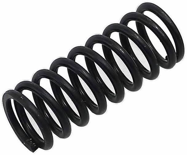

Is there a kit that you can get? That comes with the spring?
I Know I seen it posted on here under a different tranny post.
I should of wrote it down.
I figured that I would drop the pan. See how much is on the magnet. If it's really bad. Then I will just put one of the two tranny's that I have into it. But need to make sure they will work as I think one is a 44. And the other is a 46.
If the magnet is clean. Then I will probably change a few of the changeable parts along with the spring and new filter.
Adjust the two band adjustments and hope that fixes the problem.

Accumulator ? Is that the name of it? Or does it have more of a technical name?

Its called an accumulator spring. Also the RT is the same drivetrain as a standard 5.9 equipped dakota. So unless your just going for the all included optionals then just stick with what you have.
