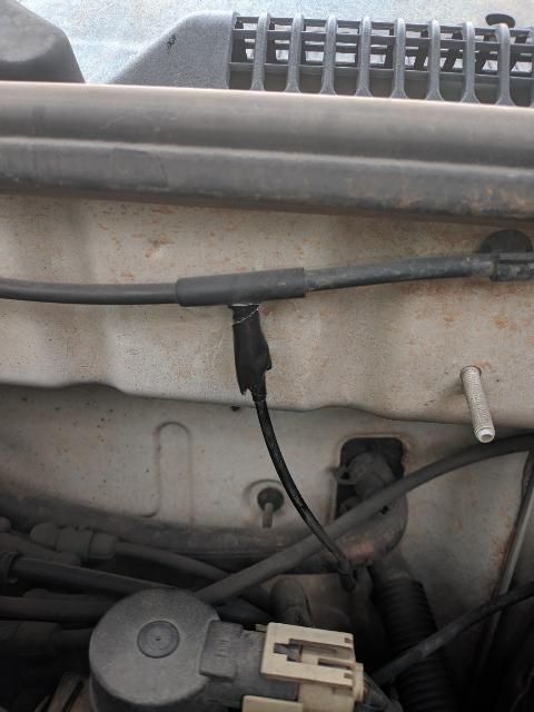

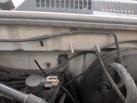

Thanks for the help guys!!!! It was definitely a vacuum issue. Easiest fix I've ever done on this truck. Attaching the vacuum diagram, and my before and after pics for anyone else that needs them.

I would get a rubber T fitting from a parts store. That tape will dry and get dusty right when you need the heat/AC the most. XD

Either that, or just a short piece of appropriately sized vacuum line to use as a splice.
