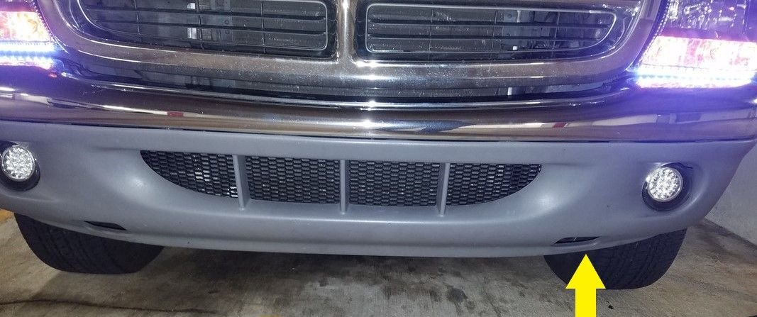

The coolant drain is on lower right corner of radiator, if you're facing the truck. I can reach mine by going through this hole in the bumper. Tight fit if you've got big hands like me.

Thanks for the info and pic on the coolant drain location!

I got to look for the coolant drain. I see what looks like a hose nipple with a round deal next to it with two protruding nubs. Is that a valve head of some sort?
