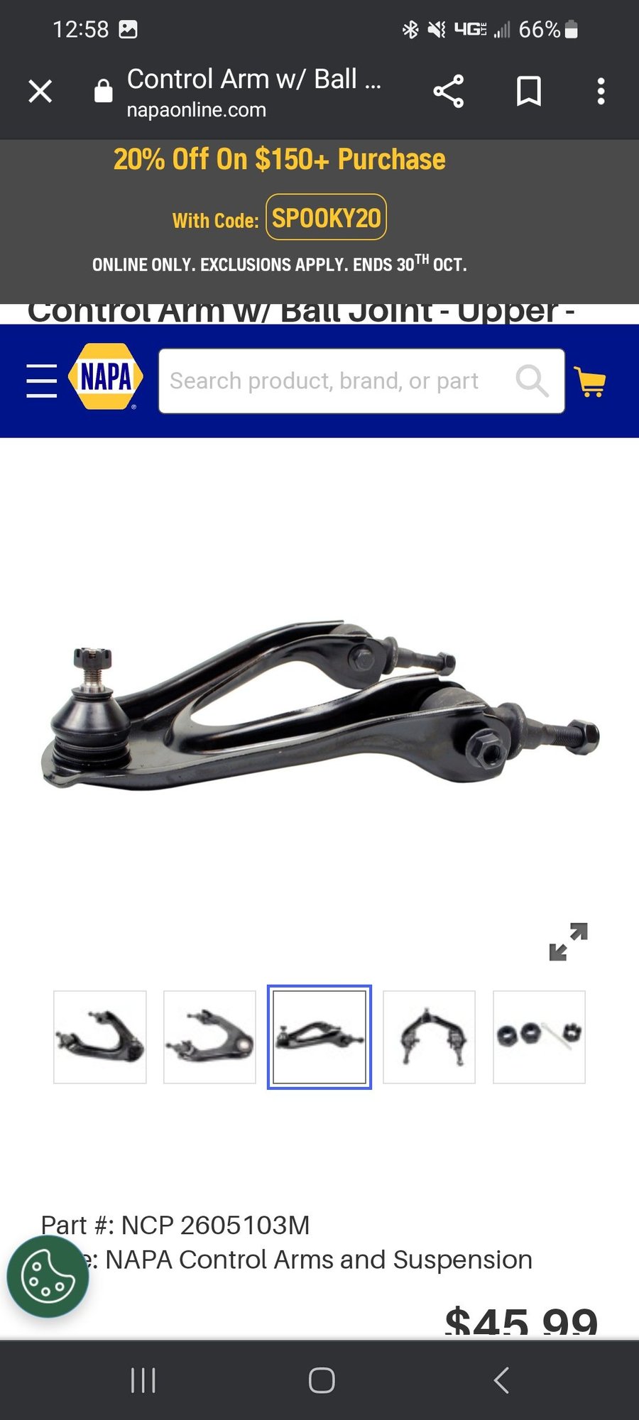

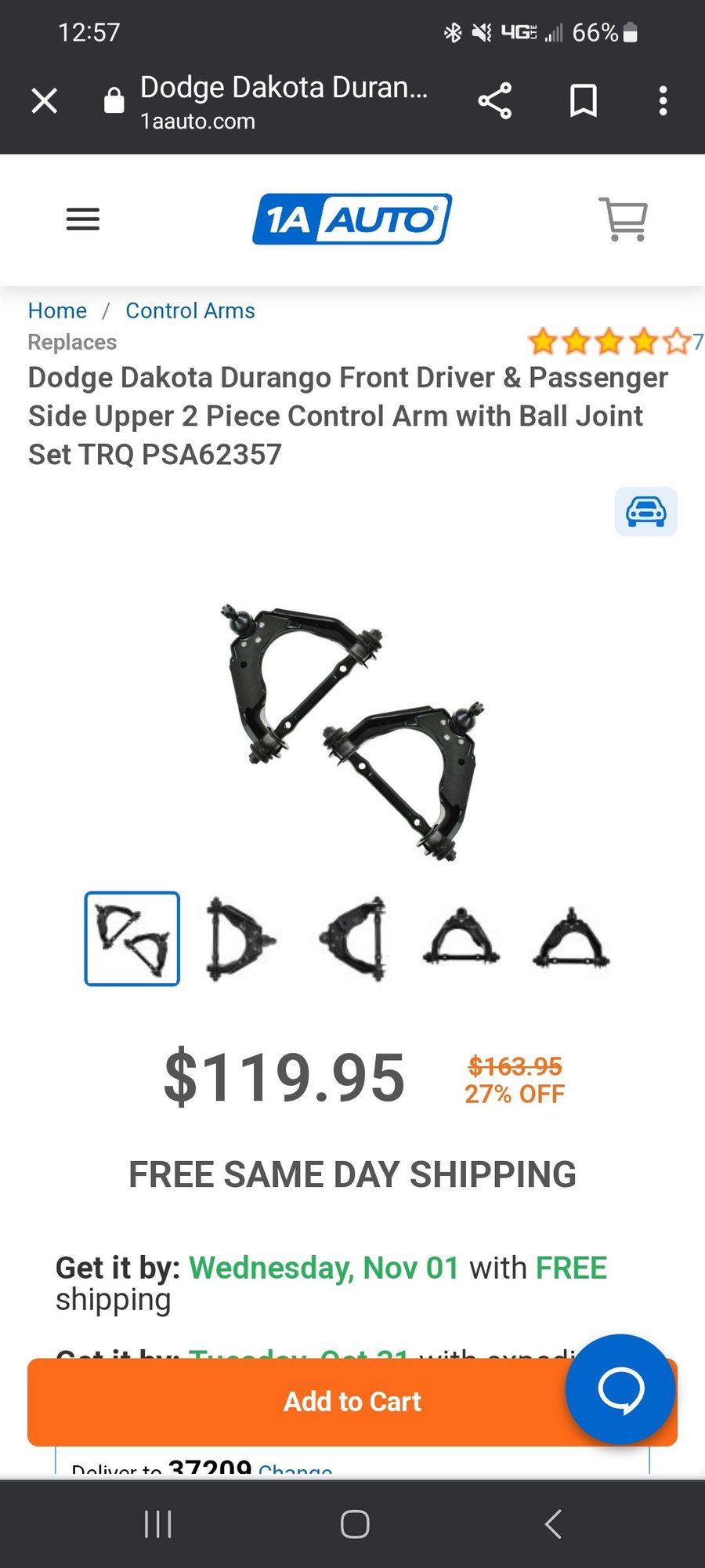

Found a few different upper control arms that look like they may work or might work with minimum fab work any idea on these? Also can't find new oem upper control arms for this truck last time I rebuilt the front end I replaced the bushings and ball joints in the control arms and had to weld the upper ball joints in due to rust so I have to find some kind of replacement ones
