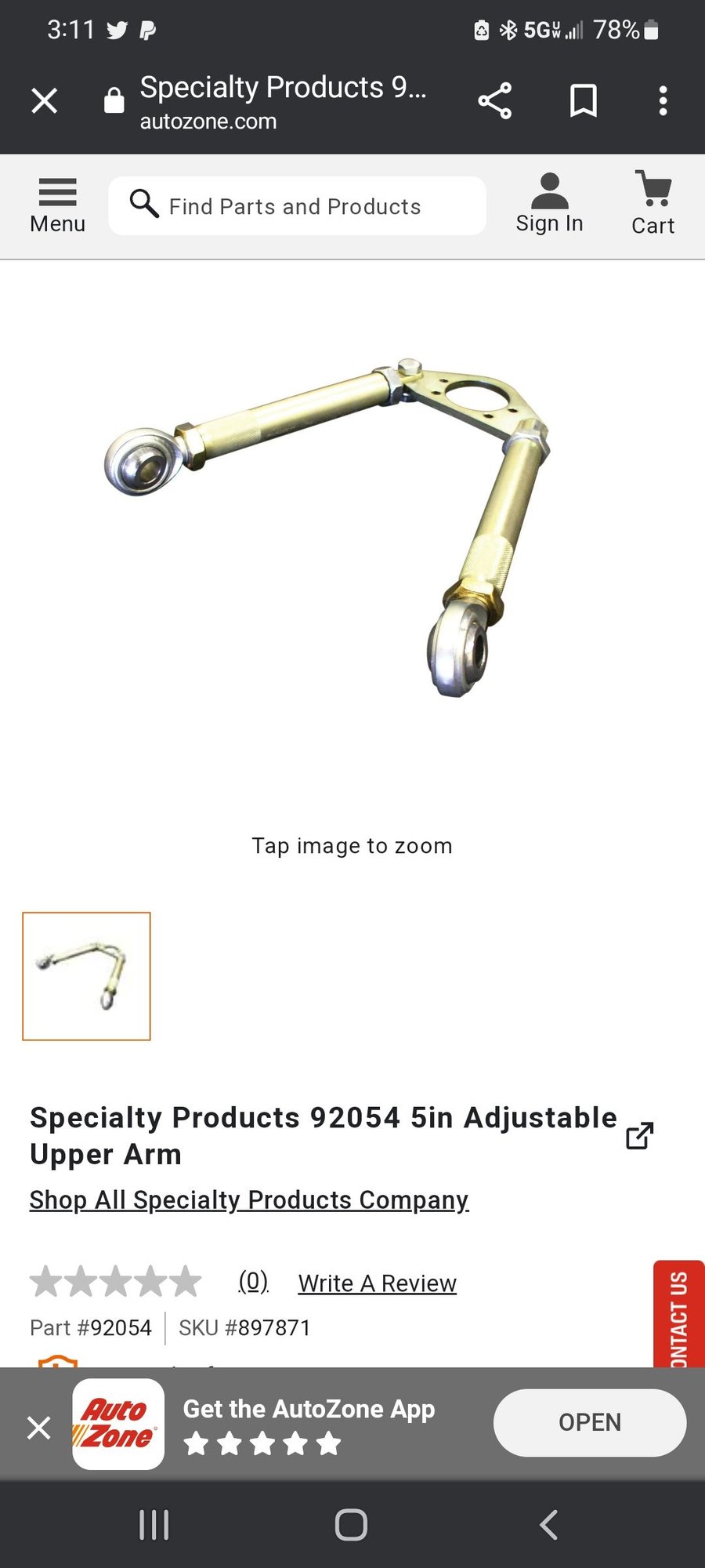

I can make the drop brackets but would rather keep the diff up if possible... I found some aftermarket upper control arms for chevy that look like I could use but would have to fab up brackets to mount them to the frame

Edit.. I can do some fab work to make two different sets work I can cut the flange off my CVS and use any axle as long as the spline count and size is right on the other end I'm building longer upper and lower tube control arms at the moment for it
