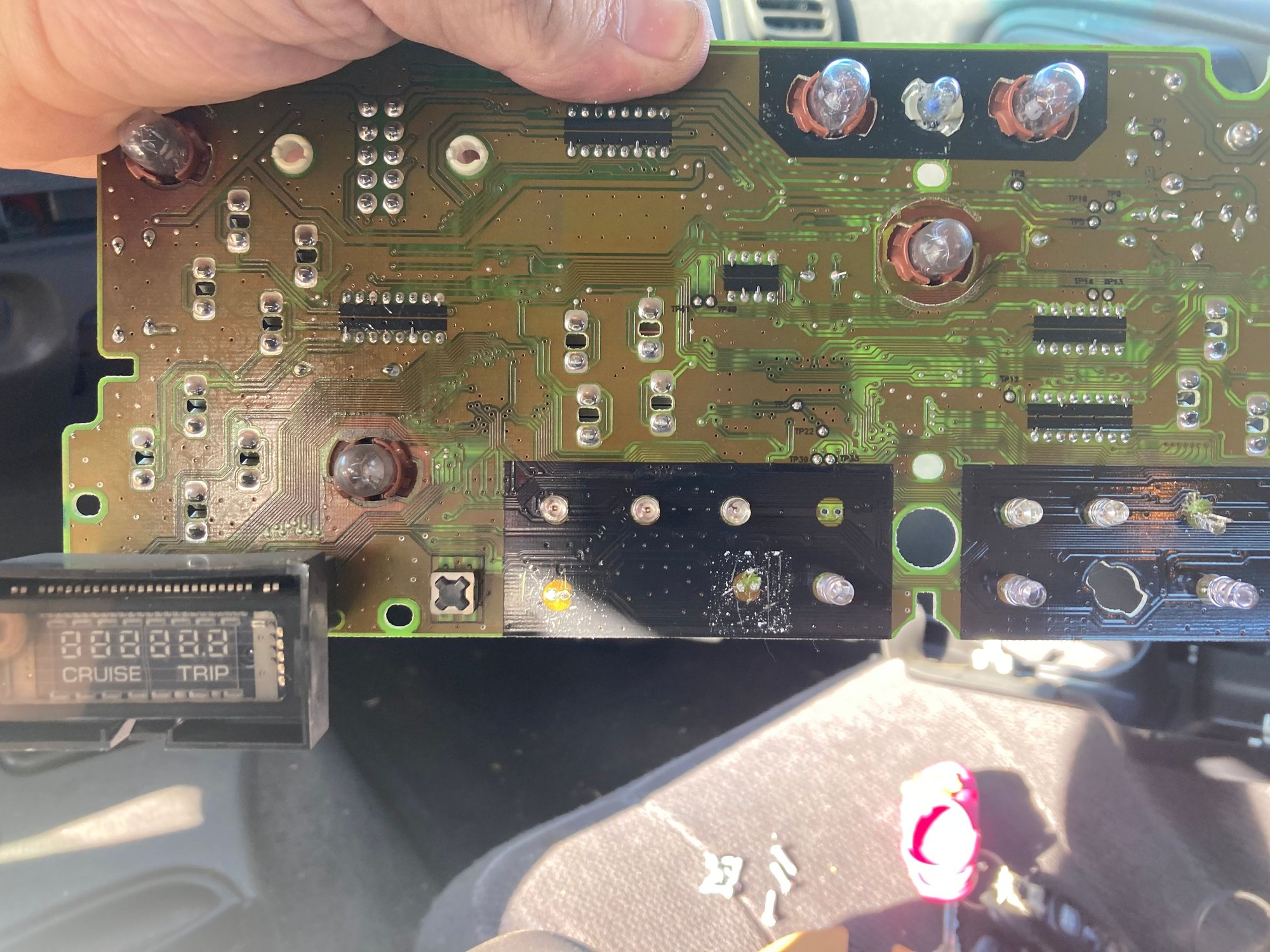

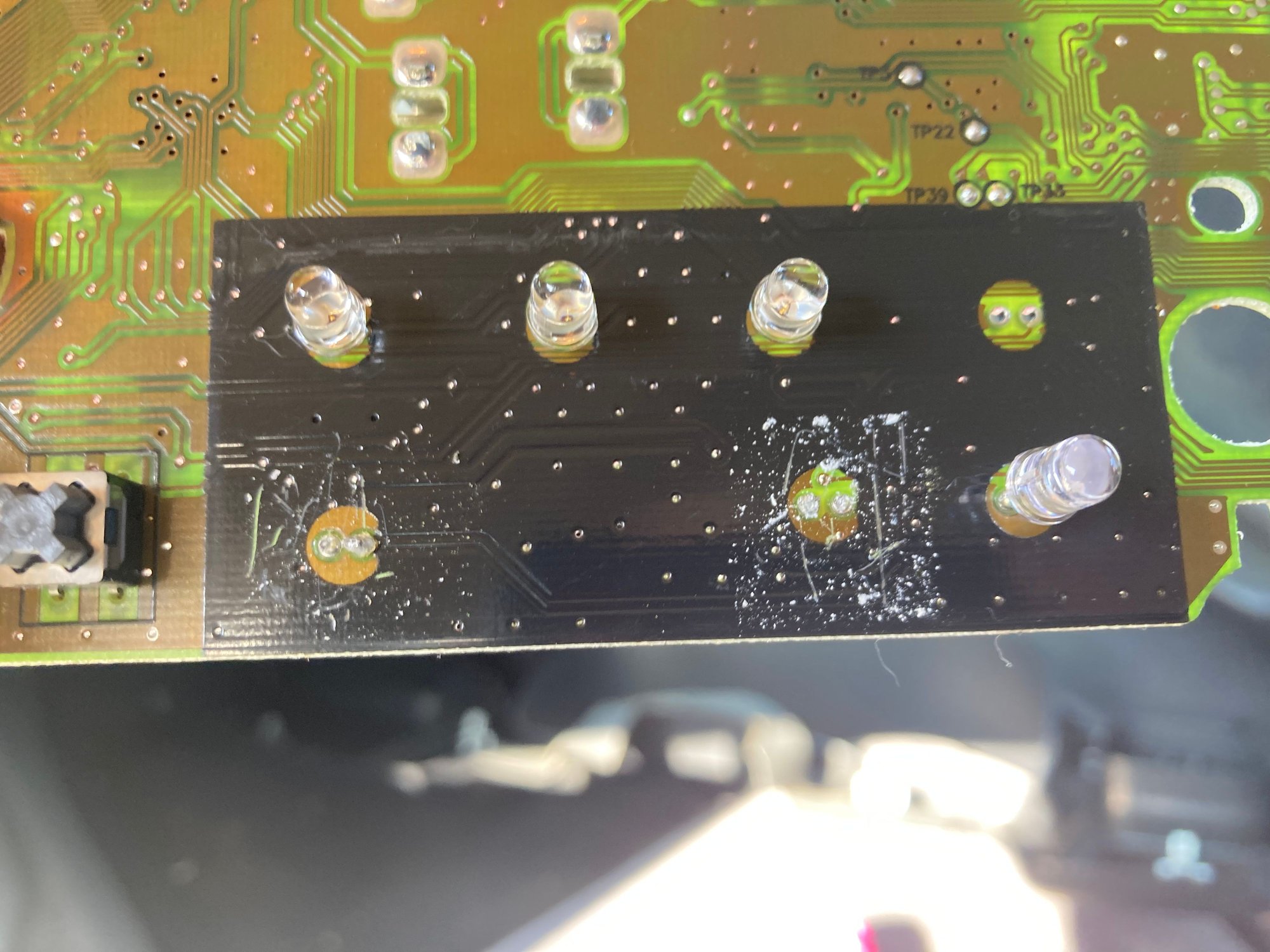

Looks like the cut off the bulbs.
the check engine, abs and brake bulbs all cut off the cluster

Thanks for the update. You may be able to find a replacement cluster. If I recall, the mileage is stored in the cluster and the PCM as well. Might need a DRB to get everything working.
