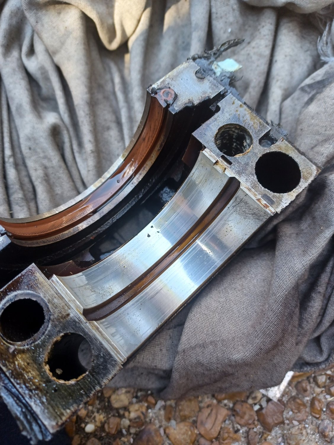

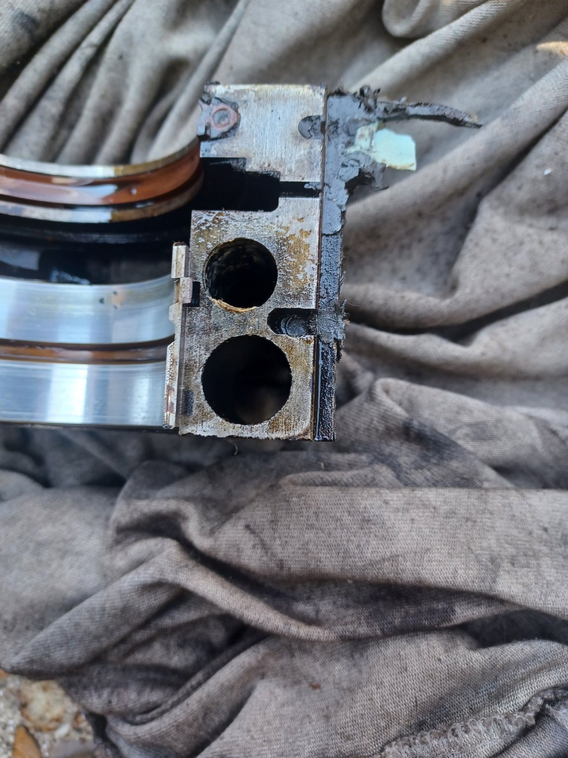

Im replacing rear main seals an wondering if it would be a good idea to offset the 2 .It does say to by 3/8" on direction..felpro.
01 dak 3.9 6cyl
Any suggestions ..an is it best to use rtv Black on edges at ends of gaskers an on bearing cap before install.an oil on main inside of gaskets.?
An should i use a dab of rtv at mate surface of oil pump too?
thanks.
Pic is after pulling it an clean up
i noticed the 2 metal guides ,between holes, were able to move a bit too but not sure if that is a issue.
Look ok?

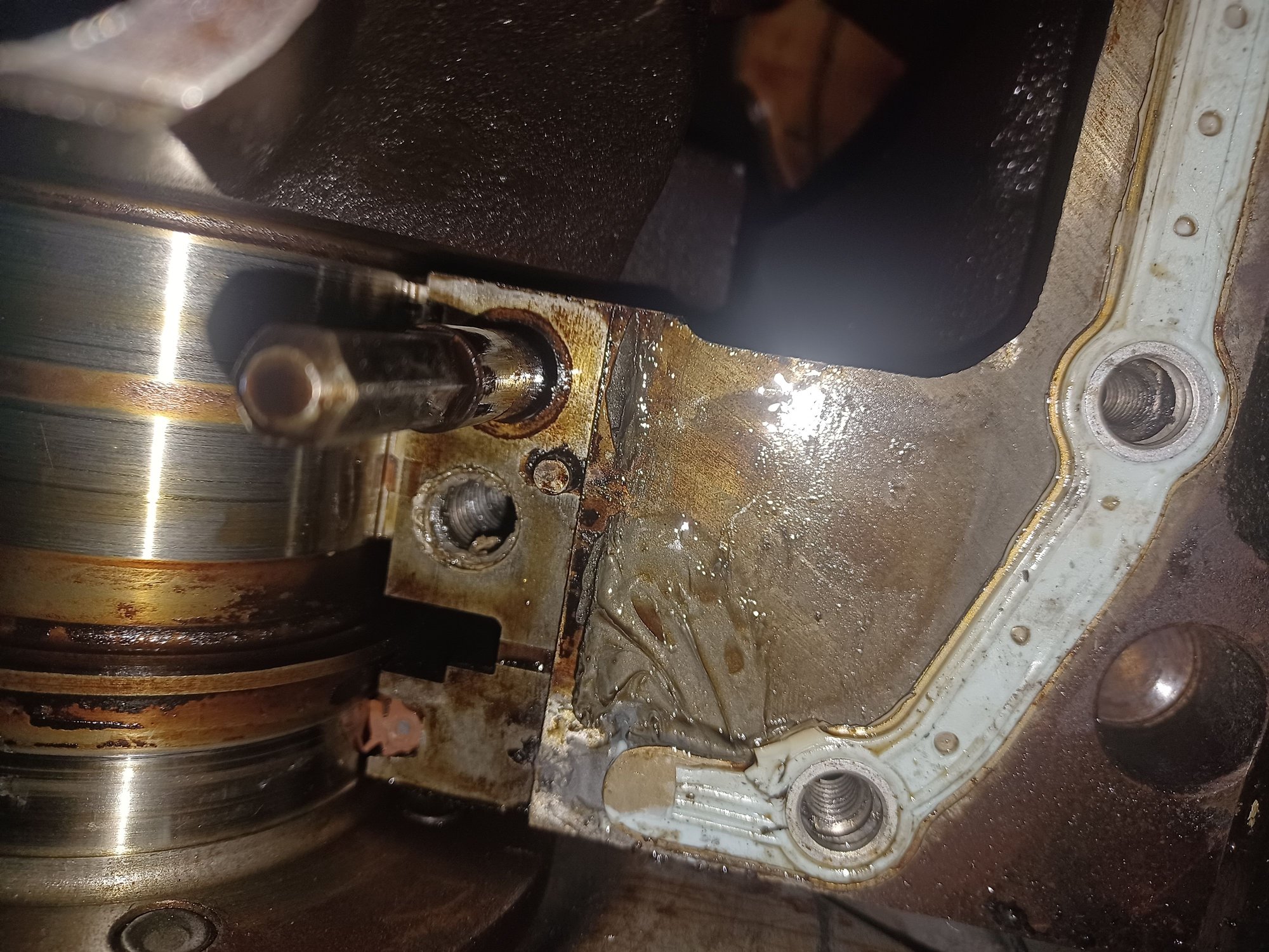

Finiahed it an set seals in 3/8 inch off center..as felpro packaging said.
Ran it 70 miles both highway an city - an still that pesky drip on flywheel casing ..
Old seal 2 years ago looked fine..
Im stumped
Changed valve cover gaskets an checked around oil sending unit....Newpan gasket also.
Any ideas ?

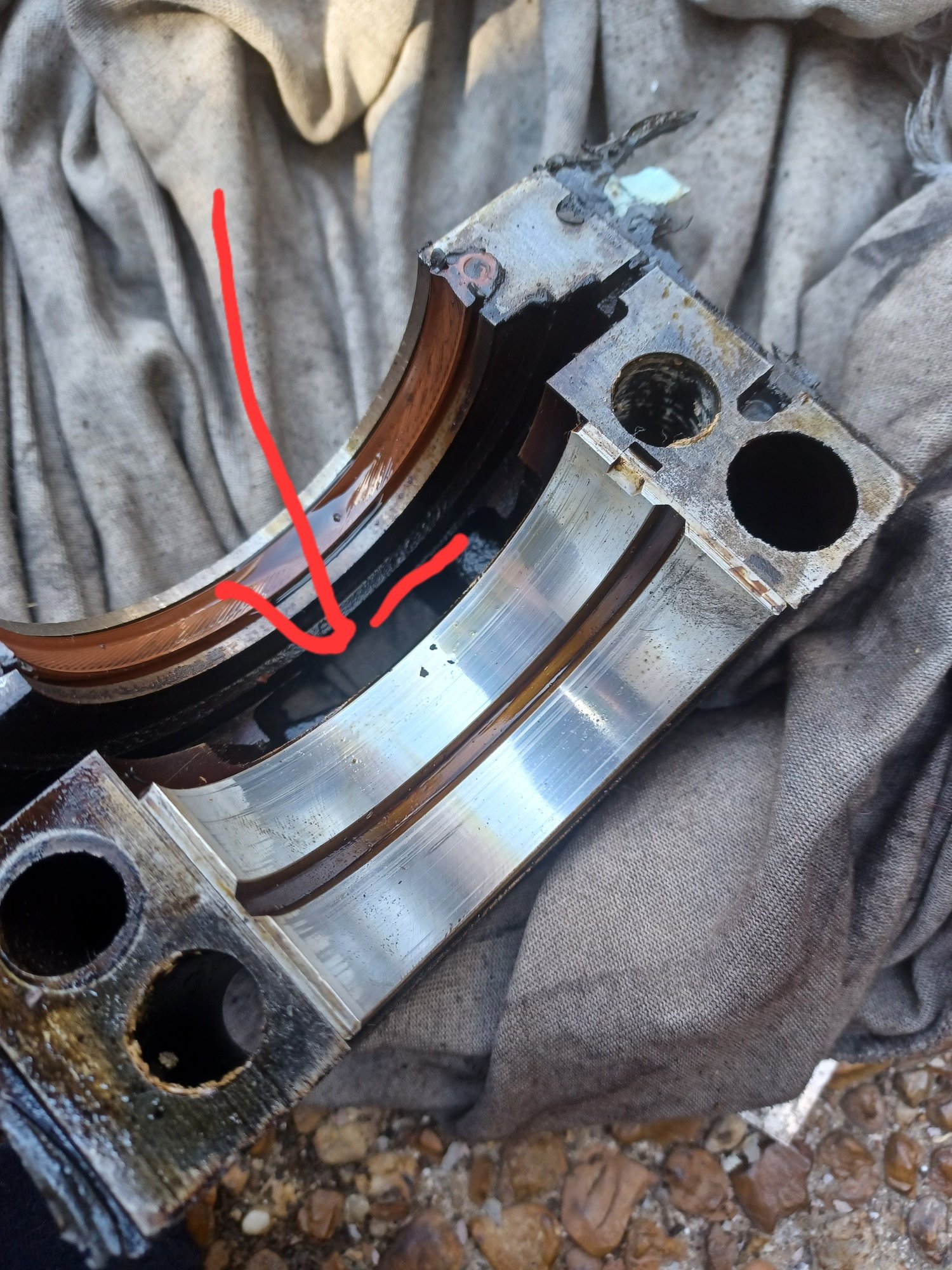

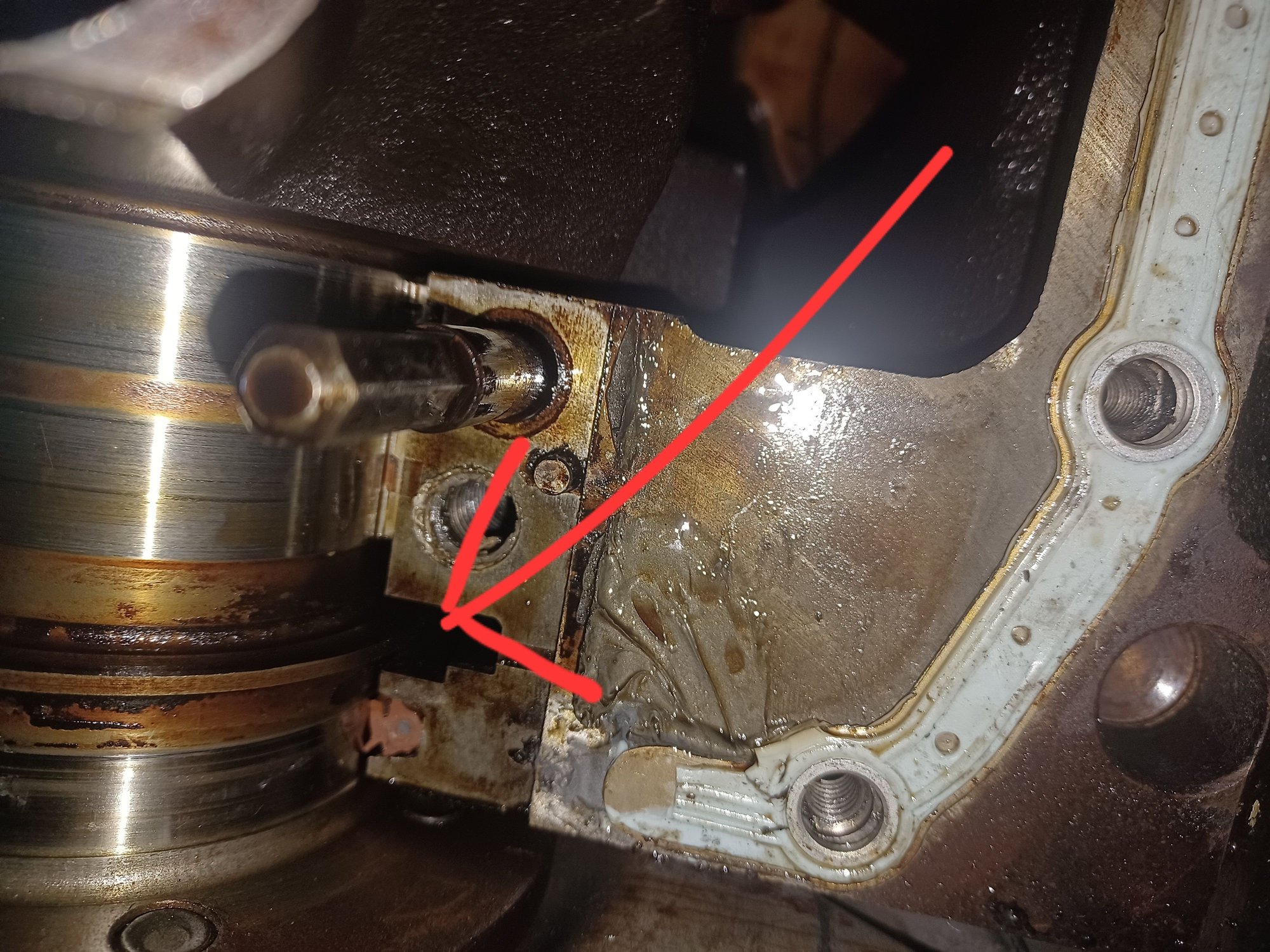

Maybe its coming from that opening in cap..arrows ?
Old Sep 28, 2023 | 06:45 AM
Posts: 87,475
That opening should be inside the oil pan when everything is assembled. Put some dye in your oil, drive it a couple days, then grab your UV flashlight, and funky orange glasses...

Ok..is it likely the bearing caps on end ? Letting it thru ?
An would replacing them fix it..at end 2 ?
Im gonna see if anz play in the shaft too.

Bearings are completely contained within the pan, when you changed the rear seal, did you offset the parting lines for the seal, and bearing cap?
Old Sep 29, 2023 | 08:03 PM
hidden1's Avatar
hidden1
Joined: Mar 2015
Posts: 752
Likes: 24
I offset the seals 3/8 inch. As felpro directions said..last were flat w cap.....what do u mean
Black rtv at flat areas of cap.. ..i didnt start it for 3 days but did have light coat of oil on seal an a dot of RTV on ends of seals.
So the sleves in pic cant be the issie? Since its fully inside pan right?
Old Sep 30, 2023 | 08:19 AM
Posts: 87,475
Yeah, the bearings don't have anything outside the pan. Its either the pan gasket, rear main seal, or the oil is running down from somewhere else.

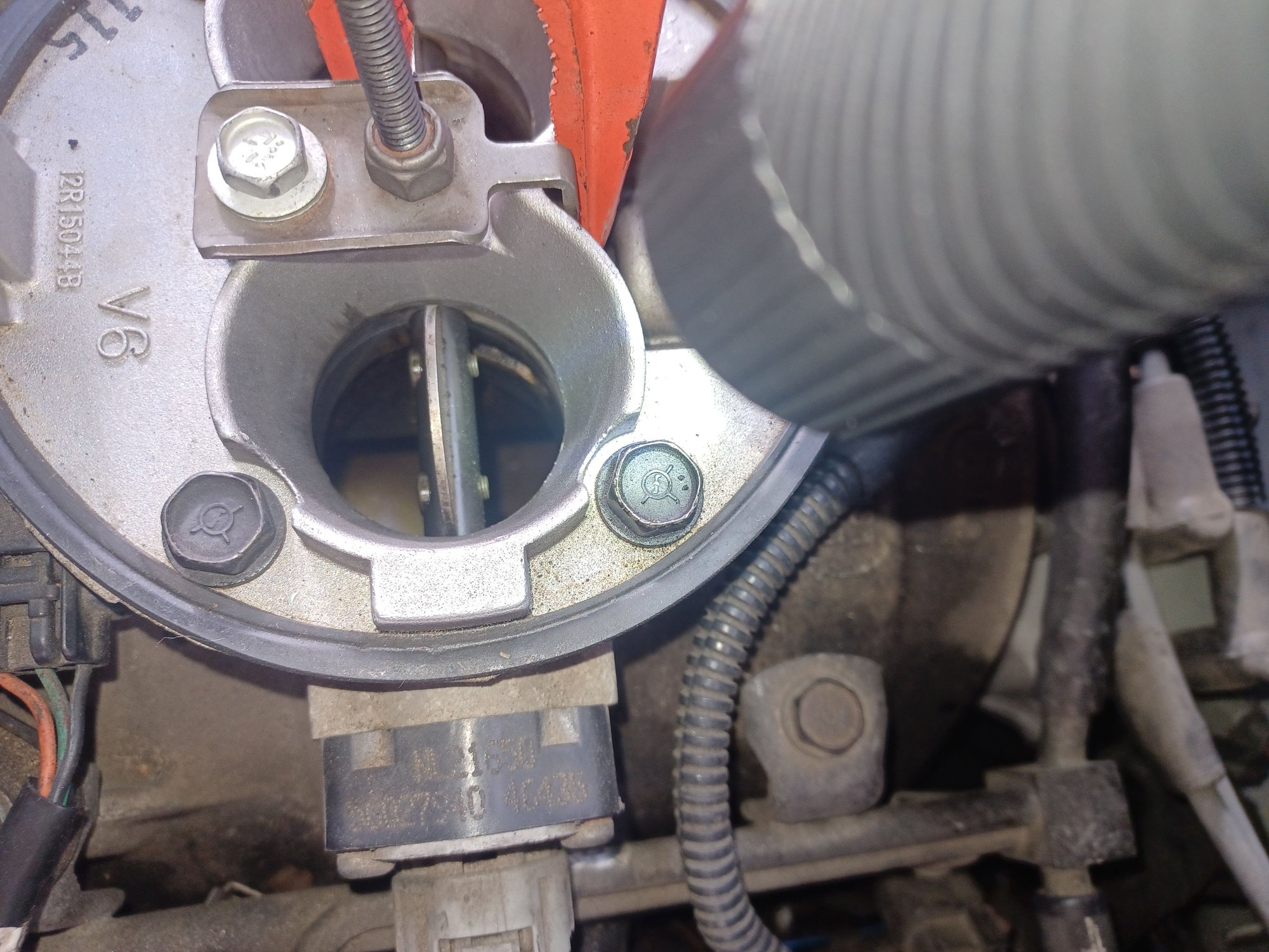

I still am seeing that lil dripon the bellhousing an drainplug a tad at curve of pan gasket near it -like its happening as im driving an spreading...what would u look at next.in 2 weeks 3/4 of
quart.
can cam sensor leakage do it ?
Im gonna tgrow another oil plug in an research for any dye but i cant find a huge loss.. maybe its burning off ..or plenum?
but i looked inside throttle an just a few lil droplet like in it..What would u look at next..or test?
