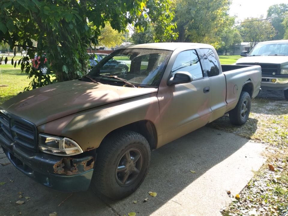

Unfortunately, the truck suffered from a COMPLETE lack of maintenance. The people I got it from spent all their money on cigarettes. The just poured gas in it. It's a shame as when it was new it was obviously well taken care of. It didn't want to get over 130 degrees when I got it. Guess why.
The truck is turning into a fun driver. If I didn't need my Ram for towing, I'd sell it and keep this as my only pickup. While I have the interior out, I'm going to drop the headliner and put a new covering in. I bought the last couple of yards of "Eddie Bauer" camouflage material and may cover the sun visors too.
Here's the before and after pictures of the truck.
I need to do a little contrast painting as well as put some stuff back on but it looks a lot better.

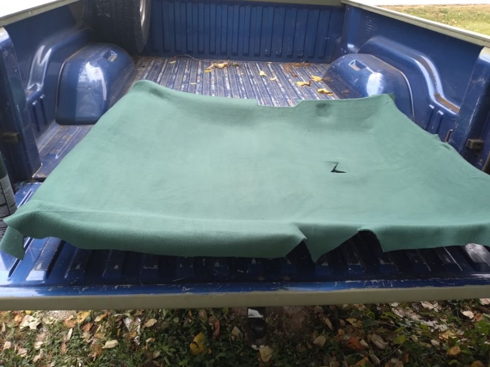

I've got the heater box back in and I'm doing some wiring work to add stuff and am about ready to put the dash back in. I pulled the headliner out while the cab is empty to make a new headliner easy to install. I'll say one thing about the old Dodges, no cardboard headliner boards. This one is fiberglass. I've spent most of the day scrubbing it with a wire brush. Tomorrow, I'll cut the material and glue it on. By toorrow ening I'll have the headliner in. I should have enough left over material to make matching sunvisors.

Well, plans tend to change. The original headliner material is water repellent. It's also glue repellent. I had to get more material. I certainly get odd looks standing in line at the sewing store. Especially when asked if I was sewing seats. I told the lady I was making a cute frock for the upcoming dance. The dash went in fairly well with the exception of those 5 screws along the inside of the windshield. Those things ate my lunch today.

I got some green cloth that will glue in just fine. Not the look I was looking for, but the camo fabric won't go to waste.

I suppose I ought to rename this to rebuilding the Dakota. Redid the headliner today. The soft cloth isn't the look I wanted but it stuck pretty well. Plus, the softer material made it easier to get the creases out. It actually looks like I knew what I was doing. I've done headliners before but an extended cab is a little more challenging than the single cabs I've done before. I also slipped and snapped the cover I bought yesterday into two pieces. Anyway, hopefully the a/c parts will be in tomorrow so when I put the steering column back in, I can get it up and running again.
I'm going to cover some older, but better, sun visors with the green. Inside looks and smells MUCH better. I didn't realize how much of the smoke smell was cooking out of the headliner. I scrubbed the inner door panels while I was at it and that yellow tobacco stream came off them. It ought to smell better but I'll see if I have some little tree smell-um good hangers.
