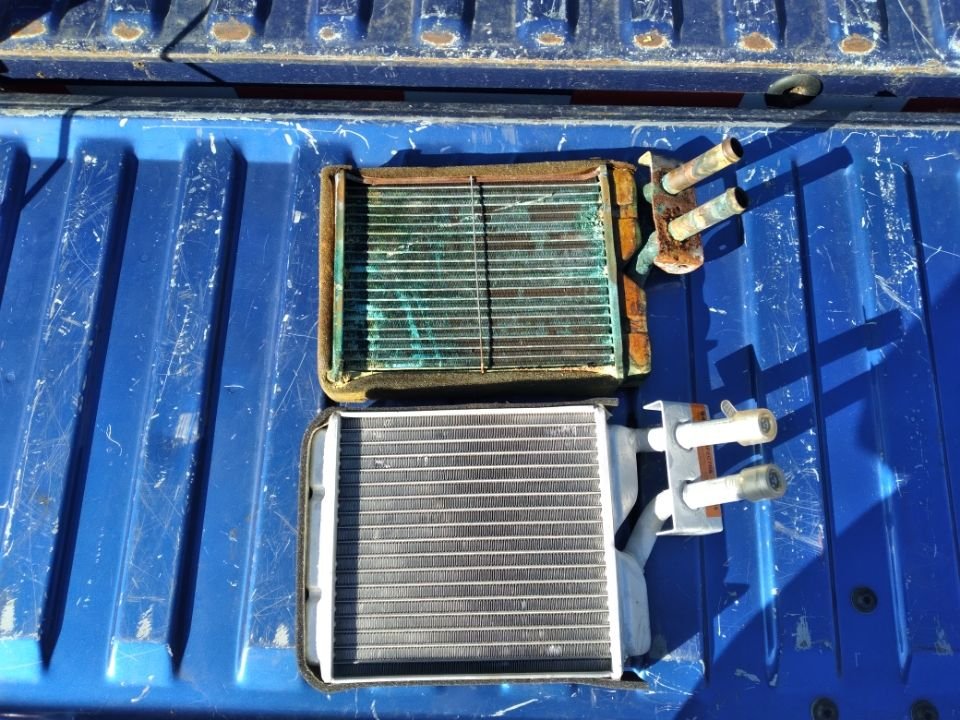

Got my heater box out and taken apart. Now I need to decide which heater core to install.
Which unit does the collective think I ought to use. I've scrubbed the inner parts of the heater box. You could see the tobacco residue running out of it. Hopefully that will take care of the cigarette smoke smell.
