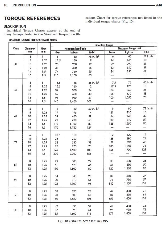

Maybe I can simplify this to help inform on a broader topic. I attached a screenshot (below) of the Specified Torque For Standard Bolts table from the 2001 Dakota FSM.
Questions:
  1. What exactly is the Class column representing?
    • Is this equivalent to the bolt Grade? Is this J429 standard? Is there a translation between GRADE, CLASS, and SPEC (ie: Grade 8 vs 10.9)?
    • What if a bolt doesn't have markings on it (like the seatbelt hanger and floor anchor TORX bolts)?
  2. Are these lubricated or dry torques?
    • Thread locker will act as a lube.
  3. Is a Hexagon head bolt (as listed in the table) with a captive washer treated the same as a hexagon head bolt, or treated like a flange bolt?
    • If I had to guess, I would say its treated like a hexagon bolt and only integral flange bolts are considered flange bolts...
  4. Do nuts follow the same torque guidance?
    • Is there any difference between regular nuts and nuts with captive washers (like those present to secure the rear seats in the quad cab)?
    • Are there flange nuts?
Thanks,
-Ryan
