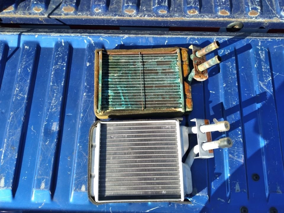

Your heater core is leaking. Probably too much for aluma-seal to stop. I put a new core in my '97 and it was a booger. I went ahead and replaced the a/c evaporator core while I was in there as the dash assembly has to come out. Supposedly, you can drop the steering column and tilt the dash back, but it was just easier to pull the steering column and dash assembly. The previous owner was a HEAVY smoker and this let me clean all the tobacco residue out while I had it apart. This is what the old and new cores looked like while I had it apart.
All those green stains are where the coolant was leaking. In the short term, you can unhook the heater hoses and splice them together. However, you won't have any heat when you do that. Somebody didn't keep the coolant fresh over the last 25 years. You need to change it every 4-5 years. If you go to a shop, because the dash has to come out, it won't be cheap.
