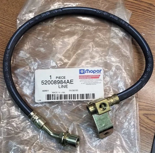

This brake line seems to have a Union on it and has some type of junction on it. But I'm guessing because you don't know exactly which part you need and you haven't even posted the year of your truck. They have variations... 03-04 had rear disc, vs earlier years.
https://www.ebay.com/itm/29659188839...hoCRxAQAvD_BwE
1997 - 2002 Dodge Dakota Over Rear Axle Genuine Mopar Brake Hose 52008984AE - Picture 1 of 3
