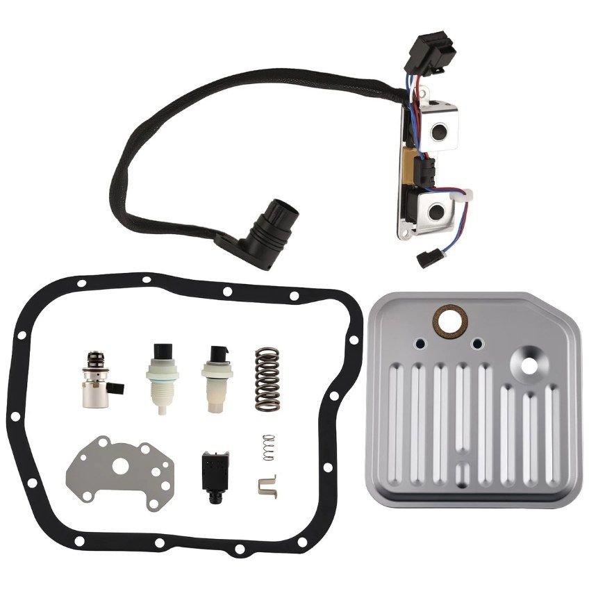

I had to readjust the TV cable ,clip had come off...I've also been testing the shifting points an even did a reset on TCM.I only took it on the highway once an not long,sluggish ..on the city roads,not over 50mph, I took it out for some major errands over 100 miles ..It's shifting ok at 1st to 2nd 18mph 1800rpm ,2nd to 3rd 28mph 1900rpm but I'm not feeling a 3rd to 4th even as going up to 55 ..it's in the automatic overdrive that it goes into after starting, an there is a tad less power than my last rear end ..no codes..Is that abs. Diff sensor a culprit or did that switch of the replacement differential factor ?..Is it in a safe mode or limp mode maybe?. .If ratio is off id think I would get a code..I also was wondering if the shift solenoid or the gov could be the issue. What would you look at 1st ?
That last differential was the culprit with that humming noise now gone-likely pinion seal. .I don't think that could have impacted the sensors but it's worth mentioning.
Any info is appreciated.
Thanks
Update..I'm gonna also replace all the shift sensors,filter, some fluid,an gov,transducer,speed sensor ,overdrive sol,,etc w a kit..like I did way BK with the 02 Dakota. ..
