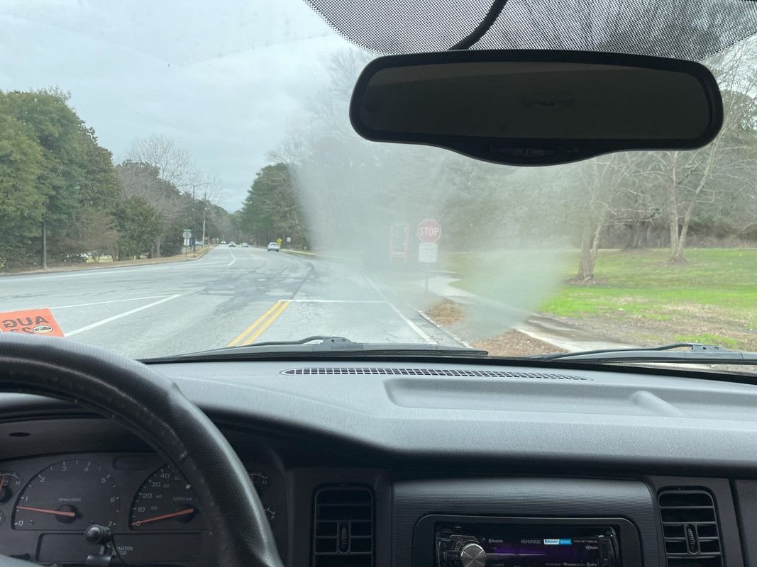

Yes, this is the inside that's fogging up and I do have that that sweet sickly smell of vaporized coolant. I just finished all that work of changing out the timing set, so the thought of pulling the dash is not sitting well with me. As a matter of fact, I refuse!!! I am going to fix this without pulling the dash. I'll let ya'll know how it goes.

Hey, fellas. I followed through with my plan and fixed it *chemically* last night. Took maybe a half hour.
Yes, this is a Dakota as you can see in my sig. I used this stuff you see below. I know most of you will balk at this but IMHO, used judiciously, this stuff works and it's not my first go-round. I used another form of it to fix my head gasket leak roughly ten years ago and am still driving. If that's not permanent, I don't know what is, but I never had to pull the heads and I'm not losing any coolant. Even now with the heater core leak, I wasn't losing any discernibly. CRC owns K&W and they makes pretty good products overall, so I stuck with them. There are are many similar items on the market but this is the one that worked for me. If I was to say stay away from one though, it would be Bars Leaks.
Anyway, if anyone is trying this, use common sense. First, read the instructions. Second, don't use it if your heater core and radiator aren't clean. I flushed my system many years ago and have only used distilled water and coolant concentrate ever since, so I'm sure it's clean. Third... don't pour this stuff in directly (even as instructed). Drain out a bunch of your coolant, then shake up the stuff for a full minute, then mix it in with the coolant you just removed (or use fresh coolant) and pour back in WITH THE MOTOR RUNNING from cold start. Keep your motor running and do your air bleed procedure, then go for a long drive. I went on the highway, turned off overdrive (to increase my revs) and drove about 30 miles RT.
Note: The instructions say only to use half a bottle for cooling systems with three gallons or less capacity. I used maybe slightly more than half. Oh and it says I can leave it in, but I plan on draining again in a few weeks.
I'm now only smelling the coolant smell as soon as I turn on the heat. It disappears soon after, which tells me I'm smelling the remnants of the coolant. I drove in this morning with the heat off and the glass did not fog at all, which was amazing to see again. Prior to this, I was seeing the fogged windshield (as in my first pic) and coolant steam wafting up from the defog vents or out of the main vents (with heat off). I'm going on a long distance drive soon and will update further.
