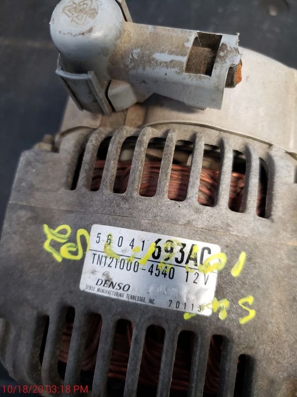

Perfect example.... I was replacing parts store alternators every few years, till I pulled this Denso unit from a Dak back in 2020. This alternator is still soldiering on today.
