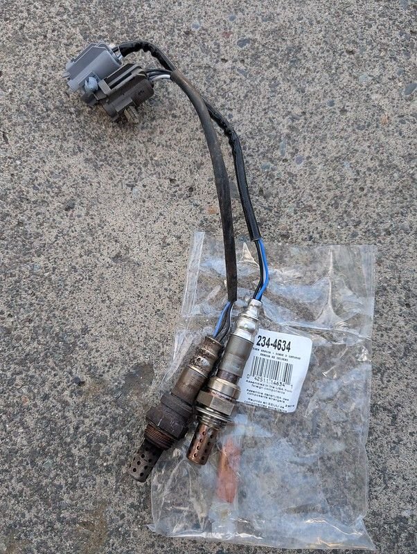

Yep, I did reference them from Denso. Quoting myself from my old thread.....
I just purchased a pair of Denso sensors last night on https://www.amazon.com/gp/product/B0...?ie=UTF8&psc=1 for roughly 24 bucks apiece (dealer quoted me $134 apiece for Mopar). Lets see if they have an effect on mileage.
I've federal got emissions, same sensor for upstream and down. At 50 bucks for the pair, I can swallow the loss if there is absolutely no difference in mileage. They're so cheap that I wondered if they were knockoffs, but when I looked them up on the Denso website, some of their recommended sellers were also selling them for that price, while some had em for double.
For future reference in case someone is looking...
https://densoautoparts.com/find-my-p...#ProductDetail (Click cross ref and type in your Mopar part # below)
My Mopar part number (dealer ran my VIN) = 56028765AA
Denso cross referenced part = 234-4718

A lot of times, the differences are in the length of the pigtail....
I would swap out the fuse anyway..... "Looks good" and "Is good" can be two entirely different things.
Okay, I swapped the fuse. No change. Same issue. Inbound email to Niterra North America, Inc., that's the parent company of NGK/NTK. We'll see what they say. Fingers crossed.

Niterra Group was super fast at returning my email, overnight, so that's cool to report. They're prognosis is that the sensor must have been dropped at some point and is faulty. They recommended referring NTK's 60-day warranty policy to the place I purchased it. So I've forwarded that email to NGK.com/SparkPlugs.com. I asked for a refund as I've already ordered the correct OEM replacements from Denso which SparkPlugs.com did not have in stock. So we'll see what they say.

Update: I removed the new NTK #23175 O2 problem sensor and reinstalled the original Mopar #56028233AA O2 sensor I took out. And... NO more codes!
NGK.com/SparkPlugs.com sent me a warranty return label and is going to refund my money. I still have the OEM cross reference Denso O2 sensors coming. They should be here this Friday.
Oh! And I've got a good system down for removing the O2 sensor. Simply five minutes removing floorboard and fire wall heat shields. Gives me that much extra room and removes the cutting hazards.
