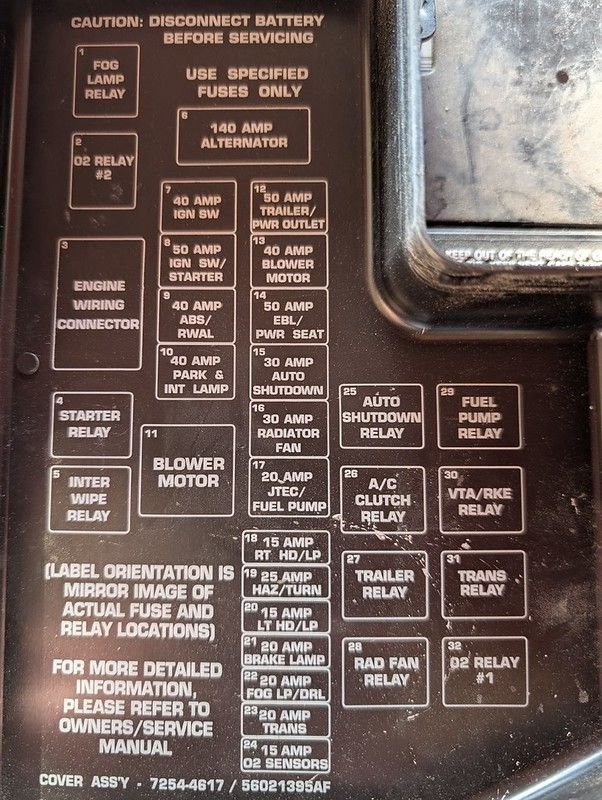

Thanks. I'll look for that fuse. Someone did say that it's the same fuse that powers the ignition coils, so if it starts and runs, it's not the fuse but rather a faulty O2 sensor. But I'll look into it anyway. A search shows it may be fuse #3 if it is the fuse.
Here are the choices in my fuse block. I checked #24. It looked good. Not open or burnt.

I have seen more issues with bosch sensors than any other brand. NTK and Denso were both OEM at one point or another. Check fuse 24.
Here:

A lot of times, the differences are in the length of the pigtail....
I would swap out the fuse anyway..... "Looks good" and "Is good" can be two entirely different things.
