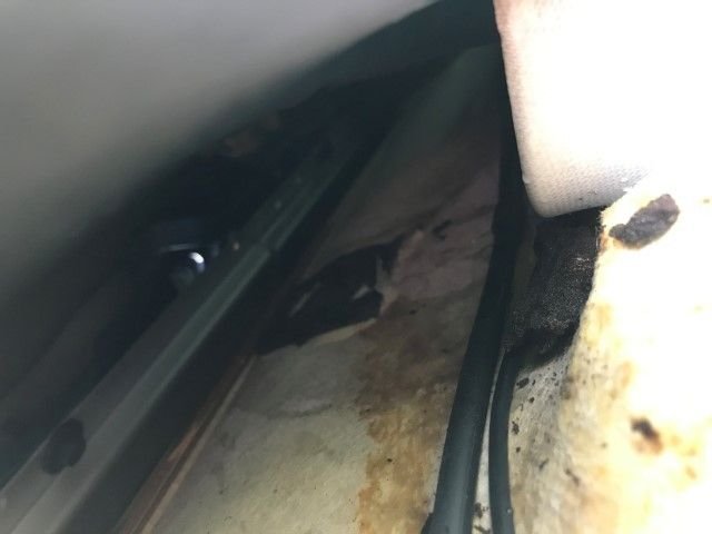

So this AM I taped off the front, right & left, & rear edges of the sunroof and selectively drenched each portion. The front, left & right edges when drenched did not leak at all, but when I removed the tape from the rear edge and drenched that, there was heavy leakage into the car interior & running down the B pillar.onto the floorboard & carpets.
After a close inspection of the rear edge of the glass, it was obvious it was not fitting tightly against both rear corners of the roof. Here are two pics from the driver's side where I had pulled the headliner away from the B pillar and you can see a bright spot in the 2nd pic. That's where the sunroof glass is not fitting against the roof in both rear corners.
Sorry about the orientation, need to rotate both images clockwise 90 degrees to view them properly:
So now I either have to replace the sunroof seal (which I don't really think is the problem) or I have to find some thin weatherstripping or similar to seal these corners. Anyone have a similar experience?
