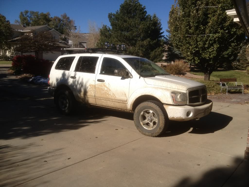

Do you have photos of your tb lift?
Old Nov 16, 2011 | 12:10 PM
MileHighRango's Avatar
MileHighRango
Joined: Dec 2010
Posts: 43
Here's a couple of mine
