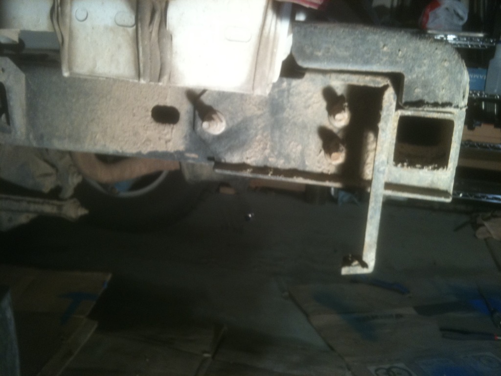

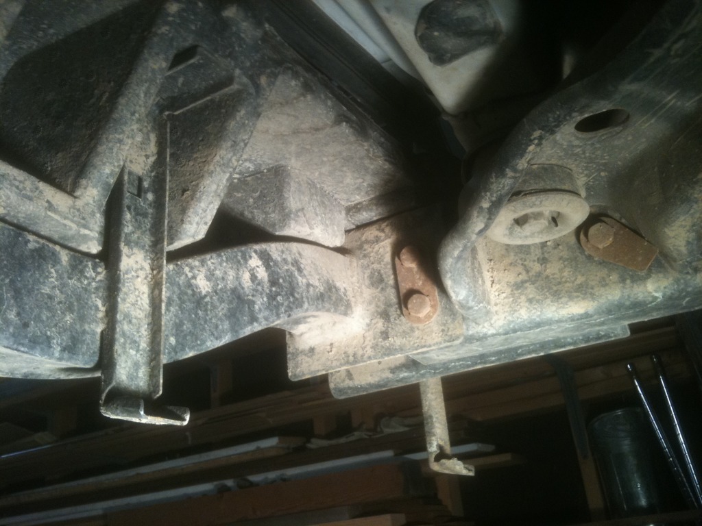

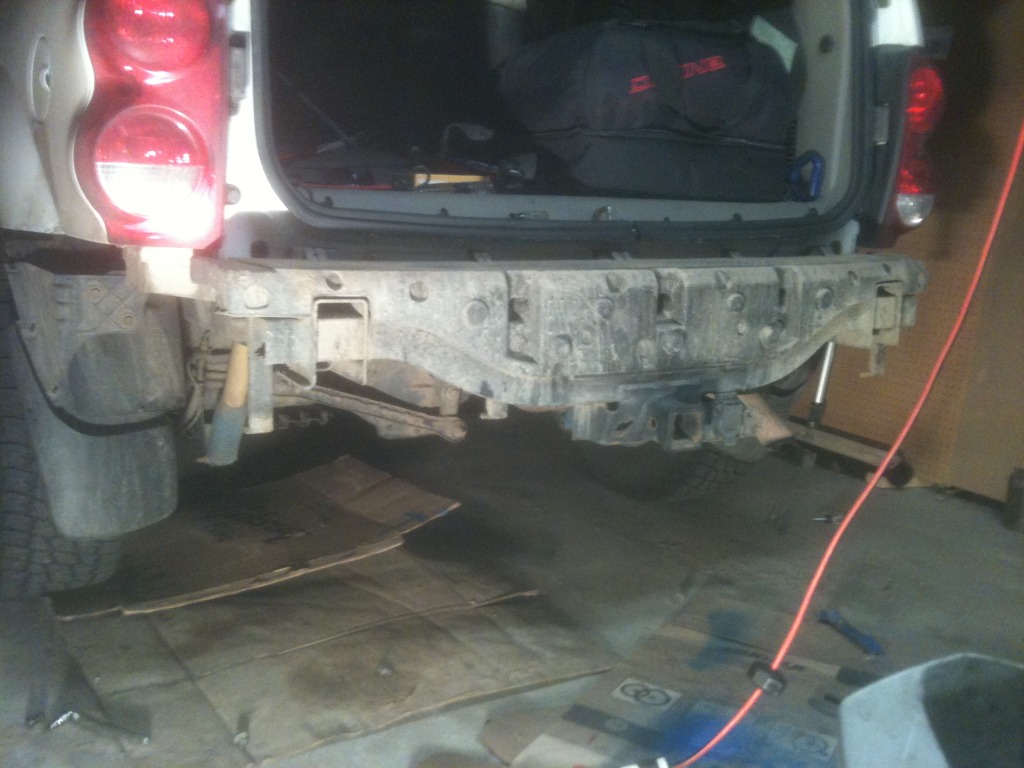

I just bought a used 2005 Durango, but no hitch!
I will be having one built in a local shop... wondering how the factory hitch is arranged: mounting points, etc.
I see some aftermarket hitches are tied to the frame rails, some to the rear cross member... none to both.
Anyone have some pictures?
Thanks, Peter
PS: I will be occasionally towing nearly 10k, using equalizers.
Attached to the frame rails, but from what i remember the rear crossmember is the same as the factory hitch without the 2" receiver, not sure if it is the same strength though. In these pictures the rear plastic cover has been removed.

Thanks for the photos.
My rear looks the same as your's but without the hitch attached to the rear cross member.
I did not realize that the rear "cross member" was actually a bolt on extending past the end of the frame rails. I think I will go with a Frame Rail attached arrangement, tied to the cross member for twist resistance.
Thanks, Peter
