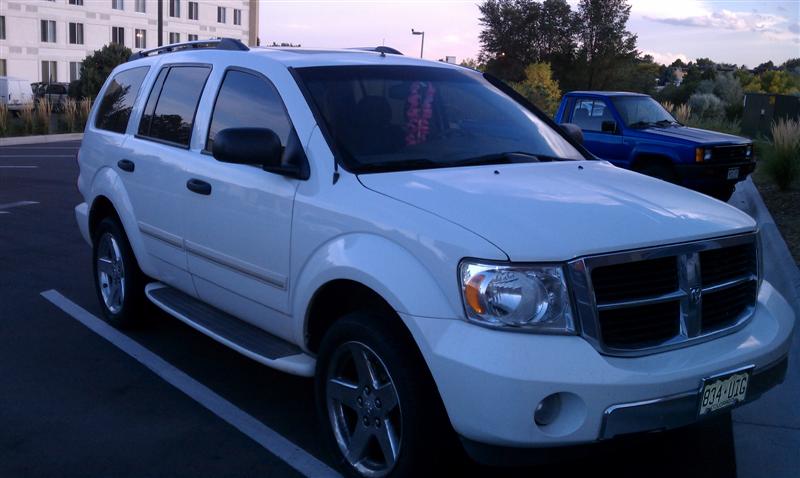

I just bought a set of Michelin LTX M/S2 in 275/55/20. Set me back a little over $1,000. #1 tire on Tirerack in it's category, 70,000 mile warranty.
Here are the tires I only considered:
1. Michelin LTX M/S2
2. Firestone Destination A/T
3. BFG Rugged Terrain
4. Yokohama Parada Spec-X
I live at 8,500' in Colorado, so snow performance is a concern. I don't want a dedicated snow tire, so I look for the best money an all season tire can buy.
I ran the stock size 265/50/20 on my last set. Definitely go with 275/55/20, it looks much better!
Old 265/50/20 Parada Spec-X's (OEM 20" wheels). Excellent tire, I got 35,000 miles out of them. Didn't want to run them this coming winter:
Old 285/50/20 Nitto Grapplers (OEM 20" wheels). These tires were on the truck when I bought it and they sucked in the snow:
New 275/55/20 Michelin LTX M/S2 (Ram 4G 20" wheels):
Before the TB lift (the day I bought her):
I have the TB lift, which lifts the front end about 1-1.5". Just takes a couple turns of two screws, search it if you are interested. You will need an alignment afterwards. Just about everyone on this forum has done it.
