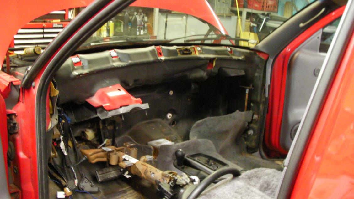

After not changing the coolant in my 98 D and having to change the heater core (see pict). I will change it soon. Is prestone or one of the others from Walmart okay or do I need the dealer stuff? When should I change the tranny, diffs and transfer case oils? should i get the dealer to do this or can i buy these oils and change myself?

I like to use the Peak Global Gold coolant which is supposedly a lifetime fill. You can use any brand you want as long as it is HOAT type.
I have also read that Zerex Gold GO-5 coolant is equivalent to the factory fill.
What ever you do, the GM Dexcool is a no no so don't even go there.
As far as your trans, transfer case, and axles, 50K is good for the trans and T case unless you tow a lot. Be sure to go back in with an approved brand of ATF+4. I like either Royal Purple or Mobil 1 for the axles.
I had installed M1 in the axles on my 01 D, and 30K later when I replaced it it looked like I had just put it in.
