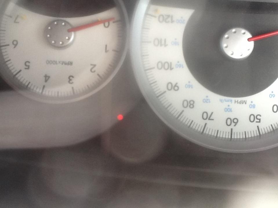

Durango won't start or even turn over. Red security system light is solid and on even when key is not in the ignition. I have already tried jumping it, unhooking the battery, resetting the alarm using the key, checked all fuses. What else can I do? I am not really in a position to have it towed in to a dealer right now.

Picture is upside down...sorry

How many miles on the D, and what shape is the battery in? Making sure that there are no open recalls is a good start.
What age and kind of shape is the battery in? If you are not sure, have it load tested to rule out any issues there.
When you do the battery disconnect reset, be sure to depress the brake pedal for 30-60 seconds while the battery is unhooked to totally discharge the system.
That system involves the PCM I believe, so if you have a bad PCM and your D is under 80K miles, the repair could be free.
Have there been any other recent unusual electrical things going on with the car?
