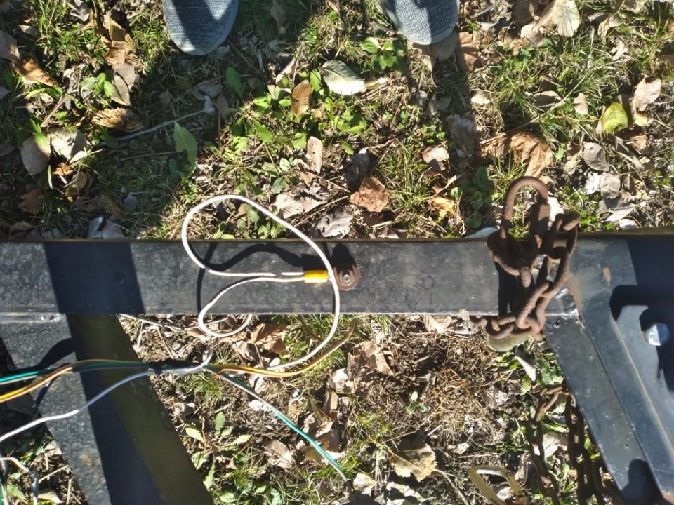

One thing I learned the hard way, if you replace your lights with LED lights, they will be brighter with a lower current draw, BUT, they need a dedicated ground for each light. Grounding to the frame isn't good enough. On my units, I changed the lights and ran each one to a common ground wire. This wire was run to a frame ground near the nose with another wire from that common ground to the ground on the connector. This bypasses the frame ground resistance. If you have a mix of incandescent and LED lights they will all work and if you just have LED, it will be easier to track down a wiring fault later.

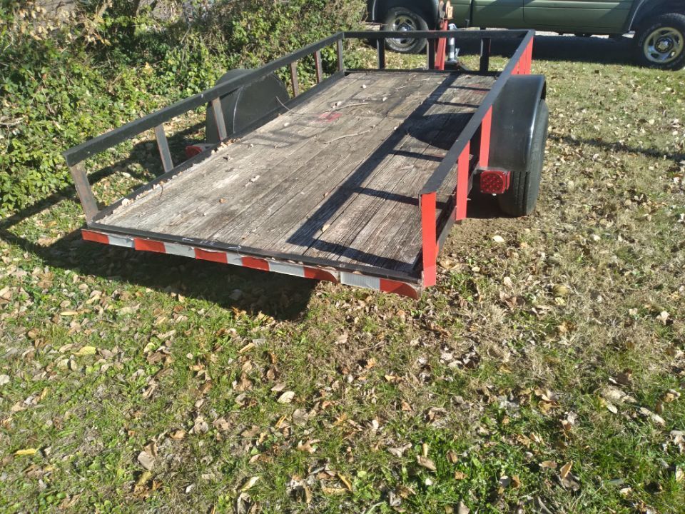

I also run reflective tape on the rear and sides. It's not required but headlights cause it to light up big at night on the interstate highways. Even more so in fog and on back roads. Large trucks are required to run it so it's readily available. I had a wiring fault once and my right trailer tail light failed. Until I got the wire tracked down and repaired, I had good illumination in the rear from headlights.

I'm farther south than you by quite a bit. The little snow we had melted so I went and took a couple of photos of my wiring with the dedicated ground wire and reflective tape on my utility trailer.
The two wires use the frame as a junction. One wire goes to the LEDs and the other to the ground connection on the wiring connector.
The reflective tape isn't required for this small a trailer but I prefer to be safe. The paint hadn't cured properly when I applied it so some is coming off. I've had the trailer since about 1990-91 and the paint had faded.
