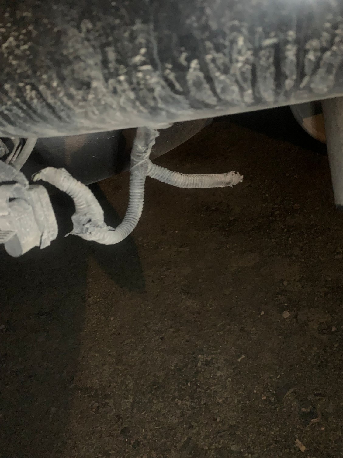

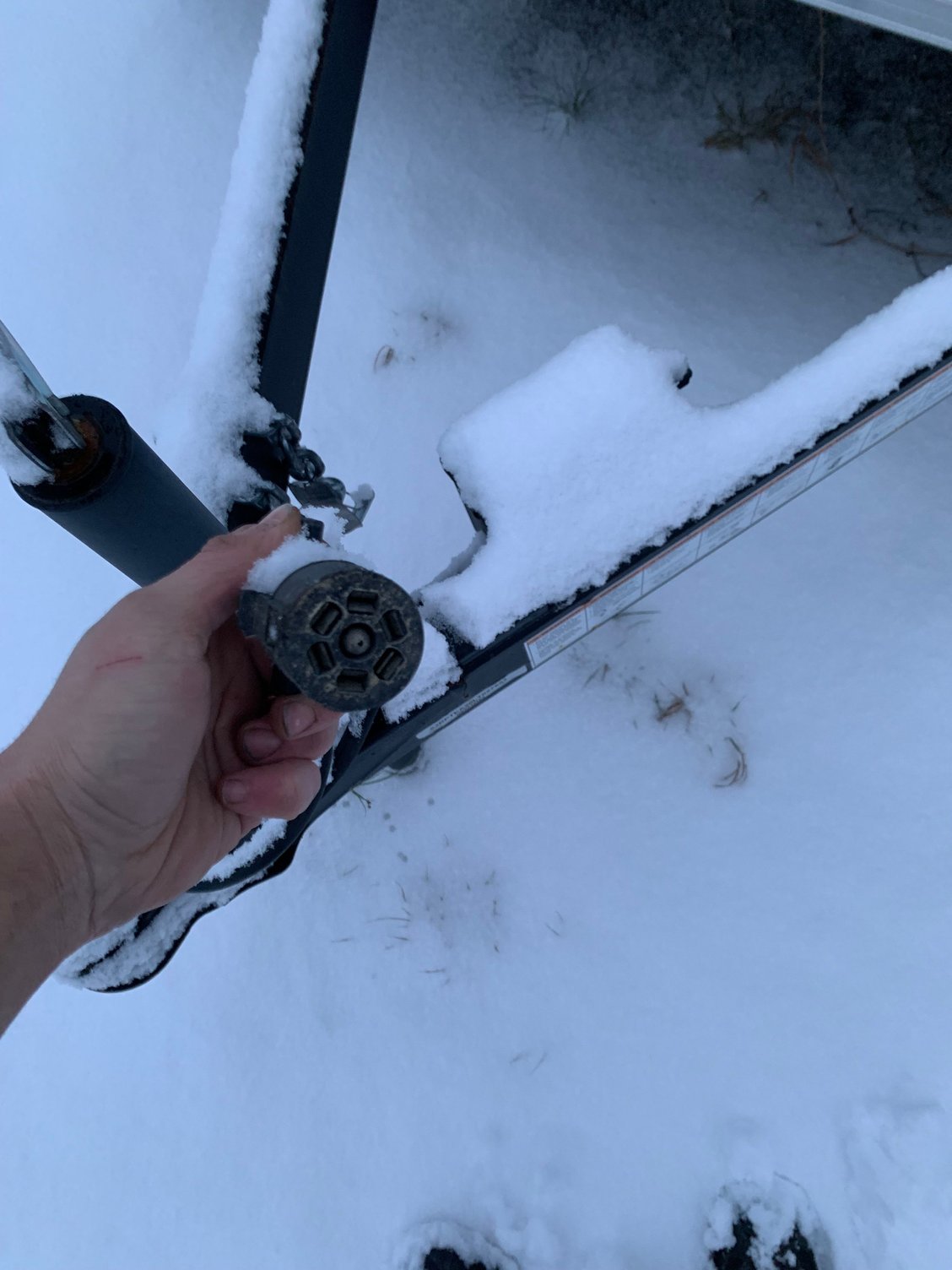

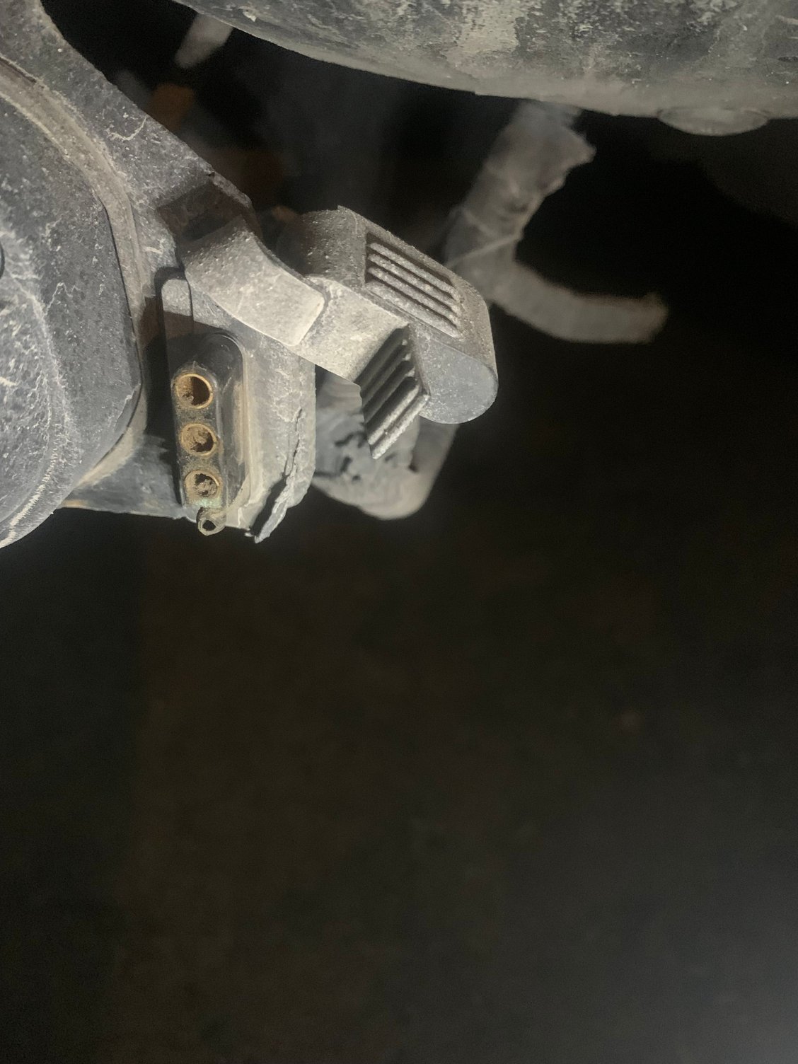

I bought a 05 5,7 Durango for towing my trailer here in Norway. It’s an import of course and had to be converted to fit the laws and trailer system. I recently found an American made box trailer and it would be cool if I could use it without converting the break system from electric to mechanic. We don’t have electric breaks.
Ther is still a square 4 pin connecter on my car and a second lead coming out of that loom, can that has to do with a sort of trailer connection?
The US made trailer has a round plug.

If the trailer has a round 4 wire connector, snip it off and put a flat four on it to match your pigtail. If your locality requires brakes, you'll either need a brake controller or convert it to surge brakes. Now, I guessing here but I suspect you have the flat four on the vehicle and the round 7 on the trailer. There is a conversion plug you can put on the back of your vehicle. It has the large round with a fat four next to it so you can use either one. I'm on the road right now or I'd take a photo of my set up on my truck. Unless you have a brake controller, the brakes won't work but the lights will.
Keep in mind that there are numerous different round plugs. I've seen round plugs in 4, 5, 6, and 7 wire connector. Some have the RV blade connector and others have the round pin connectors. This is similar to what I have.
https://www.autozone.com/electrical-...5&gclsrc=3p.ds
On mine, you plug your flat four into the back and if you need to add a brake controller, power to the trailer or what ever, you wire it up direct. This will let you connect either one directly into your vehicle.
Thanks
We have to have brakes on everything above 750kg 1600 pounds
The car has now a 13 pin plug which is standard here, so I have to connect the brake controller separately and just change the connector on the trailer
How would I see if my car has a brake controller, sorry never seen one and don’t even know how they work.
