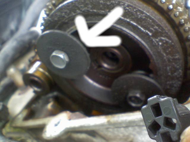

After taking off the timing chain cover, I hand turned the crank and found a spot where the chain had a little slack going down to the water pump.
After removing the valve cover on that side I found the culprit of the chain slack. A bolt had loosened up and was hitting the inside of the valve cover, enough to wear a slight hole in it. I thought the belts were moving slow for a start.
Haven't had a chance to go farther, but any thoughts on collateral damage?

2 teeth off on the timing chain and you got 24 bent valves (personal actual experience!)
