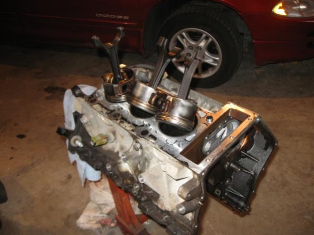

got the motor out, spun a rod bearing. can someone recommend a web site to just remove the crank, my Haynes manuel just shows how to do a complete teardown, I want to leave the heads and not mess with the timing as much as posible. thanks,

I rebuilt the engine, It took me a couple weeks of nights and a few beers,
but its in and runnin great, Broke it in yesterday, 67 miles. kind proud of myself,
