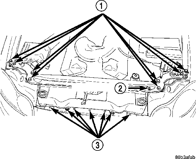

Found the answer. The the upper radiator support needs to be either removed or loosened so it can be moved up and away. This is not particularly difficult or time-consuming, and makes room for the bolt to come out, as well as makes it easier to do things like adjust the belt tensioner. The headlight skewer bolts need to come out as well.
I just took out the top set of bolts in the diagram below and was able to move the assembly up and forward enough to do the work.
Recommend putting penetrating oil onto all screws and bolts associated with the upper radiator support, and cleaning rusted threads well, on the screws/bolts and in the holes.
