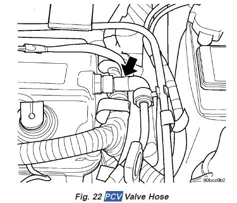

I want to install a catch can because it's a cheap, effective mod, but I can't understand the directions for it. I'm reffering to the $20 mod. I wish there were some better pics for it.

i dont have pic, but i have one going on the line from the right side of the valve cover to the intake manifold. it catches a lot of oil. it fills up the $20 catch can between every oil change. i would reccomend it

Its really not that hard man... The catch can goes in between the PCV line that runs from the valve cover to the intake system. Find where you want to mount it, cut hose... valve cover side goes into the "in" side of the catch can, the TB side connects to the "out" of the catch can. You may or may not need more hose, depending on where you mount it.
an non-turbo neons do not need them, they do not create enough pressure in the system to force oil out of the PCV.
yea thats where it goes, nice pic, but i beg to differ on the non turbo cars thing. unless my car is a freak or something, but mine does fill up. not anywhere near as close to a turbo car, but its still a lot of oil that im taking out of my intake manifold
