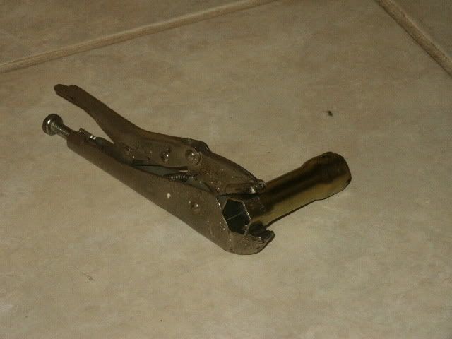

Yes, the clunking is because the top nut is not tight enough.
All you need is this little DIY tool...(21mm 1/2" drive socket with a 19mm socket and extenson)
Or this one...

haha.. Thanks man.. i saw the tool being used and i couldn't figure out what size it was.. finally got the suspenson in the front all adjusted correctly.. doesn't look like its an inch and a half on the threads tho..
oh well..
