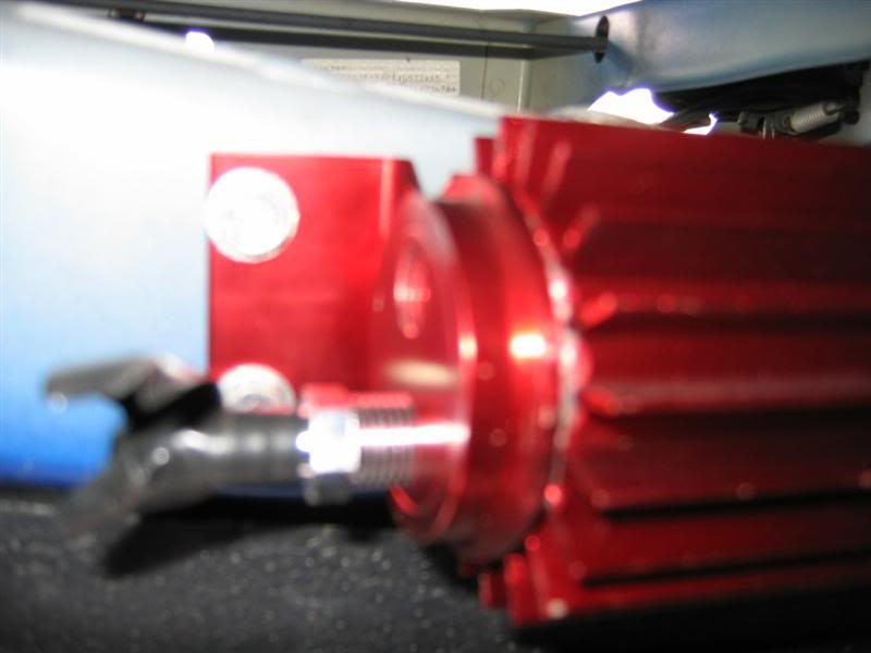

Hope you guys dont mind me picking your brains some more... Not really sure why I'm having a hard time grasping the concept? Think I'm just worried about hooking it up wrong somehow. The pic thats attatched shows the 2 lines from the tranny as you standing looking at the motor. Do you know which one is the return line? If the one on the left is the return then I was thinking of taking that line off which runs to the far left side of the radaitor. Gonna get a line that runs from that far left side of the tranny to my cooler I have mounted. Then from the other outlet on the cooler, run another line back up to the tranny, thus completing the cycle... Does that sound right to everyone??? I took one of the fittings on the cooler off to get some line tomorrow that fits!
I mounted the cooler in front of the radiator, with some self tapping screws to that piece that runs across
the front of the car. Not blocking any of the radiator, plus there it's gonna help cool even better! Looks awesome from the front as well!Thanks for your replies everyone!!!

You're not supposed to use your stock lines...i recognize that one from ebay. Mine came with a hose and I used it.
I ran out to my car right now, the return line is the one on the left.
Usually, you start the car and let it idle for a bit. The hose that isn't as hot is the return.

So I'm good to go then Adionik? The way I described is ok???Yeah i know i gotta get some more line and afew hose clamps, gonna do that tomorrow when I'm out and about... Thanks for your help bro!
