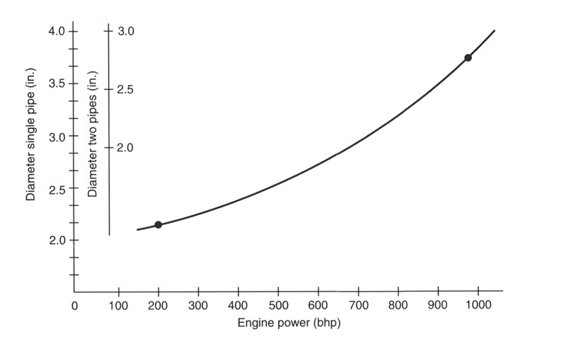

3" of exhaust on a stock 420a neon engine???
OMGZ!!
lol. Seriously though, the 3" exhaust will completely ruin your torque curve. If your getting a new exhaust stick with your 2.25" tubin for best performance. Buy a full Borla or Magnaflow set-up if your sticking with a N/A build.
Here is my reasoning for anyone who questions why.
the curve right there tells you, essentially, when your exhaust tubing size becomes too small.
As you can see, our stock 2.25" tubing is great for our uses up to 200 bhp. Now, unless your doing a full engine rebuild, high compression cam and pistons, long tube header... everything to get that thing up to aroun 180whp I doubt you need 2.5" of exhaust.
Now, why you see people going out and buying a catback muffler and saying its a performance mod (kinda like myself), is because the stock 2.25 in. tubing becomes restricted at the muffler to 2.00 in. Buying a nice muffler will increase horsepower on the grounds that you now have a full 2.25" exhaust and a hugh-flowing muffler.
Its up to you on what you get. Depends on your setup.
I knew I was oing to turbo at some point, so I bought a cheap muffler to keep me going.
