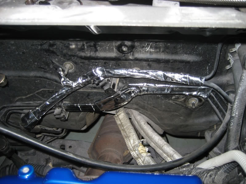

Well I worked on the car a bit tonight, but not much though... I picked up some heat wrap for the lines on the firewall so the Turbo exhaust manifold wont' melt them..

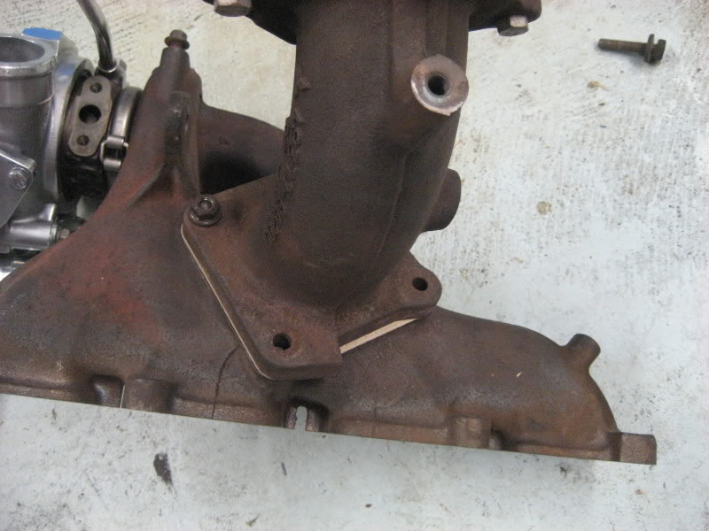

I also wanted to mount up the O2 housing to the turbo fold, but I'm missing the damn bolts... Grrrrrr.. Anyone know the correct size they would be so I can get some this weekend.

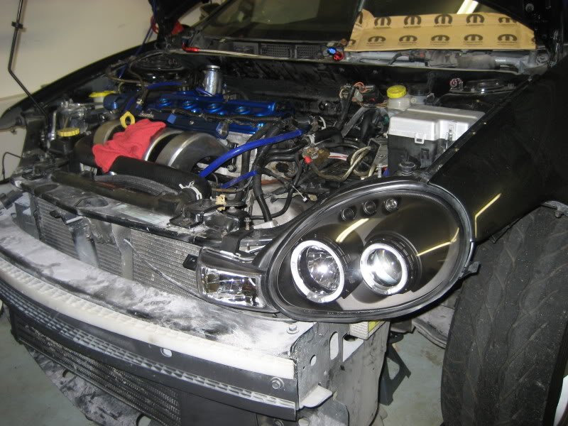

I also took off the headlights off and gave the new ones a test fit..

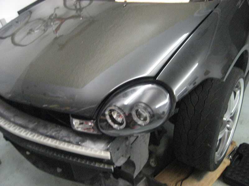

Hood down

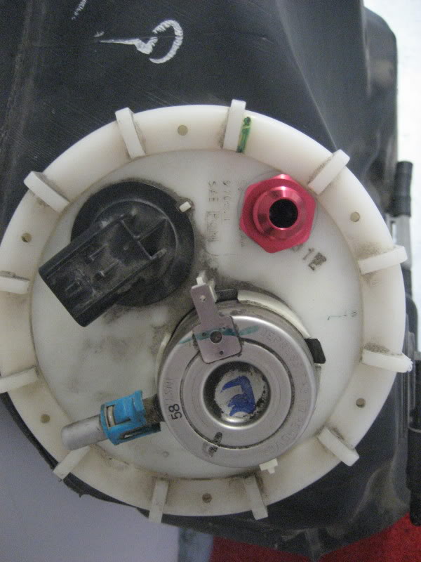

Oh I almost forgot.. I picked up the return fitting that I can mount it on the access cap. I have a 1/2" drill bit and I need a 3/4" to make it fit. I"m going to do -6 from the regulator to the tank, so I need to pull out the second hard fuel line out of the way.
Will post pics tomorrow.

damn it, i really like those headlights... ugh.... sometimes i wish i did not convert to 03+ headlights. but i may go with some like that at some point....

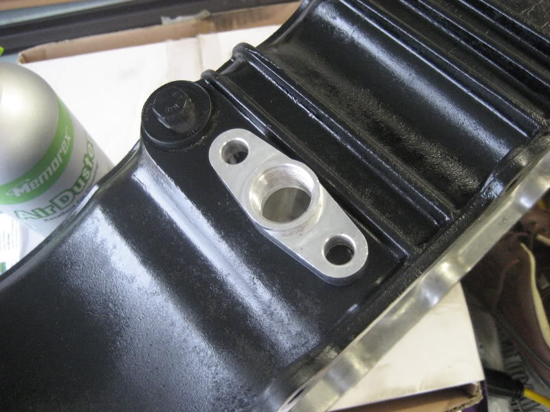

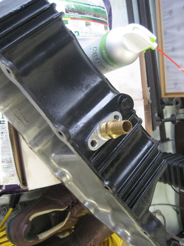

I also took a uni-bit to the oil pan to make for the return line, and now I'm kinda torn if I should drill the other two holes and bolt it to the oil pan, or find someone that can weld the fitting to the oil pan. If I weld, then I need to modify the fitting, and if I bolt, then need to make a gasket so it won't leak...
main hole drilled.. and bolt area mocked up.

What it should fit on the pan..
and what it should look like once I figure out what I need to do next

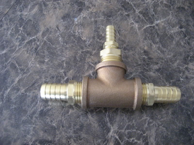

So here I am again at a stand still. I also am trying to figure if I should do the cooliant "T" or try to get another hard line and drill and thread a 1/4" NPT in it to run the lines....
What you all think???
