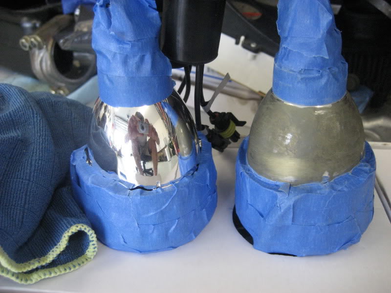

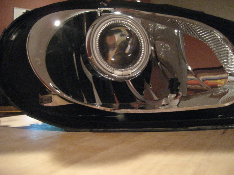

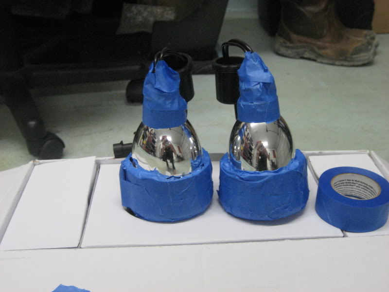

Well, I did a bit of work on the projectors today. Sanded the chrome down, shot the black primer and then layed out the Semi-gloss paint.
taped up.
One sanded and one not...
Sanded and cleaned up ready for primer.

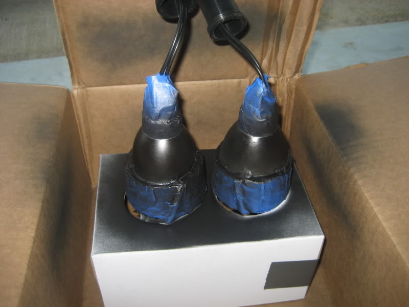

Primer on...
dried and semi-gloss layed out. Going to give it an hour or so to dry a bit. then i can make a choice to either do another coat or not..

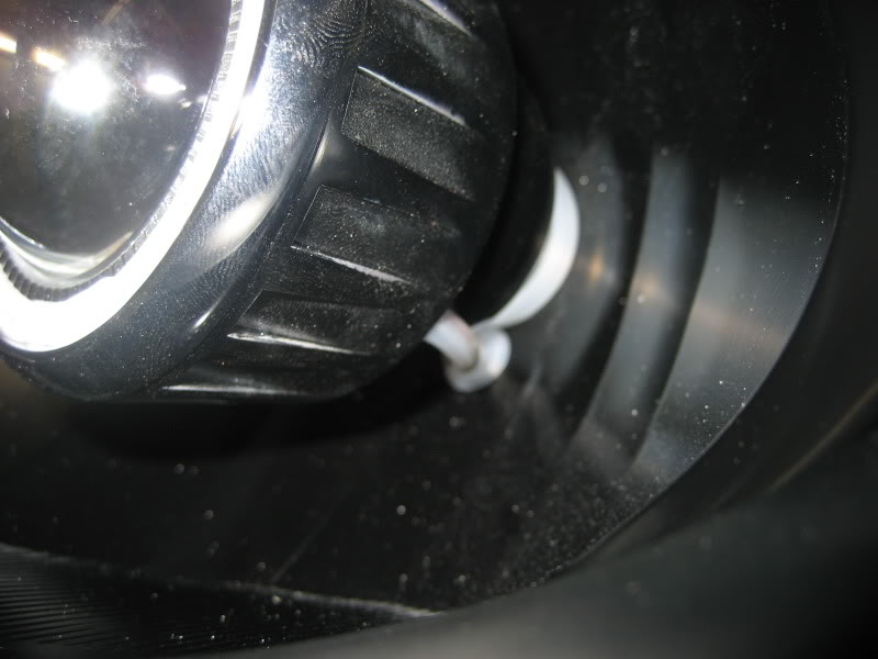

and here is the gunk that was giving Isa'kee issues. I guess that the TYC lights are not like the DEPO style....

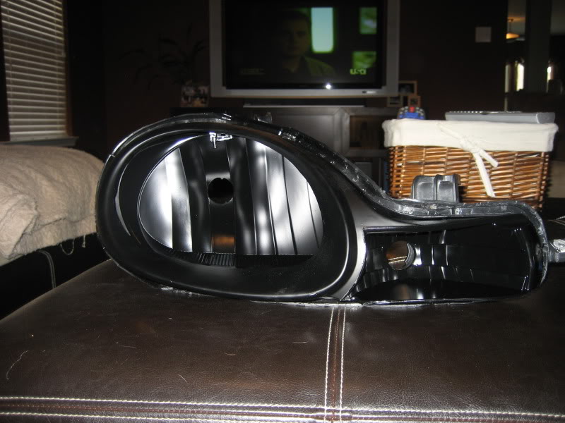

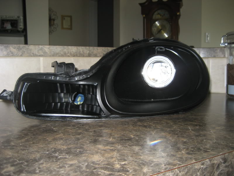

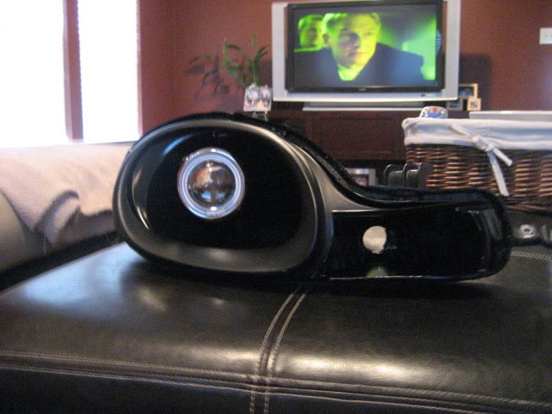

I took off the tape from the projectors to see the blacked housing...
not bad....
I test fitted them into the housing and I'm pretty excited....

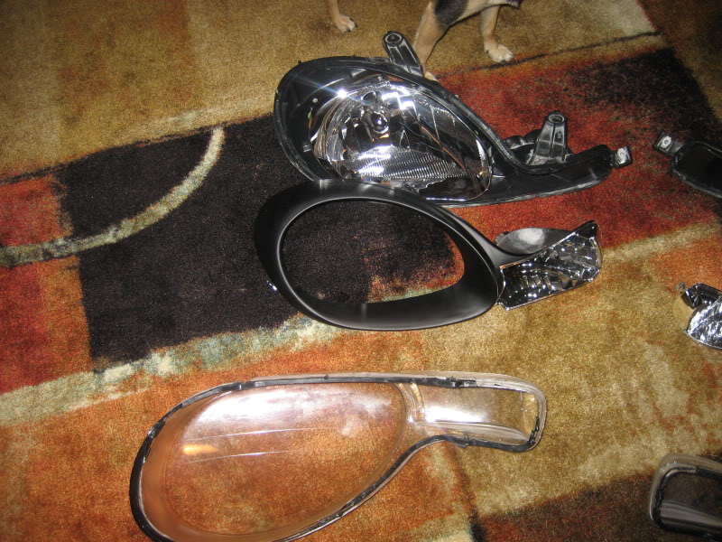

I wanted to see the Raccoon shrouds set up.
I'm going to start to sanding it down later on tonight or tomorrow.

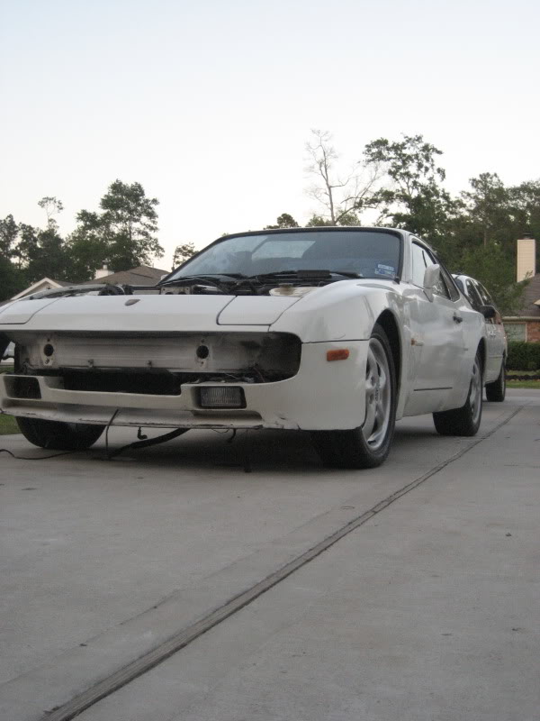

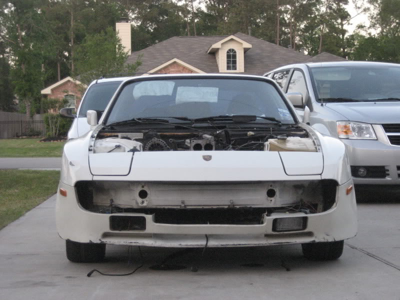

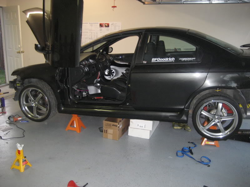

I didn't get back to the lights today, but Matt and I got a lot done on the car today. Here we go on the pics...
Car is moved to the 3rd garage bay...

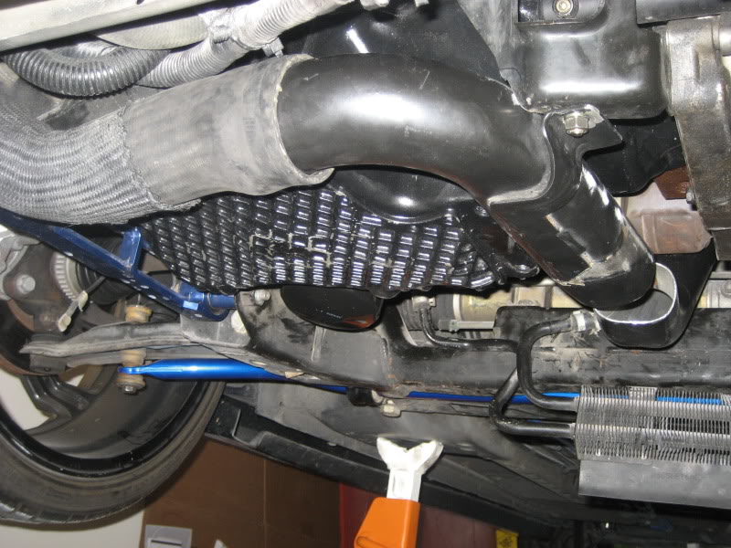

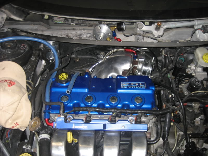

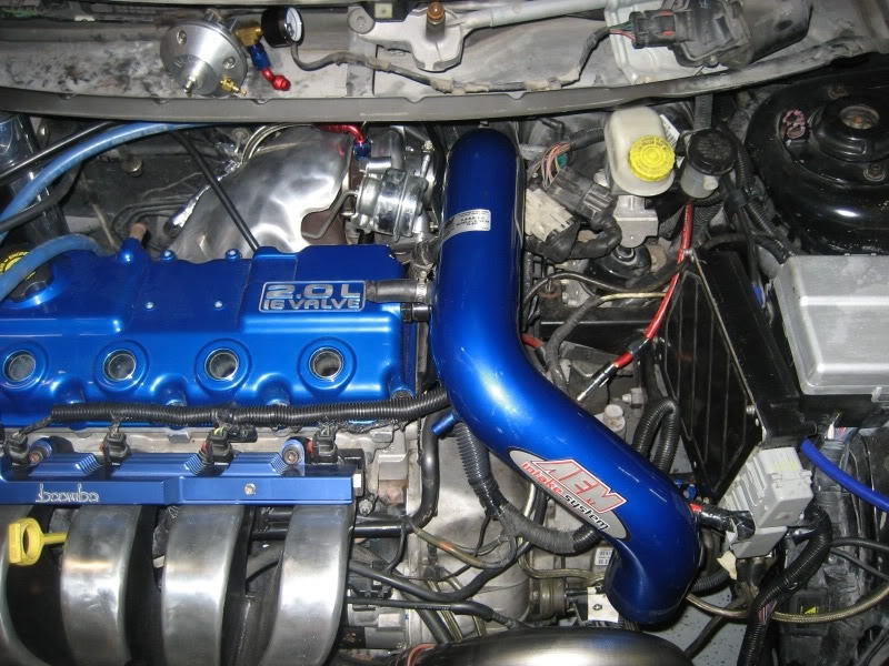

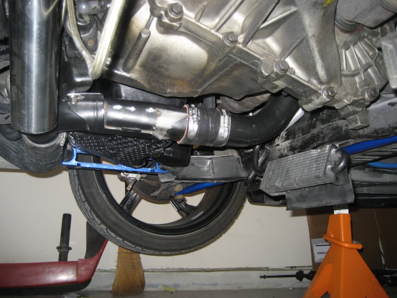

Exhaust mocked up again and installed. I still need to get a gasket for the flange near the muffler.
Relocated the return line..
Hacked up the hot side piping to make it work properly on the 2.0L
Another mock fit of the cold air and the J-bend for the cold side. Also thinking of relocating the computer to where the battery is.
Mocked up bracket and sealed hot side for the time being.
Oh and here is the White beast out in the sun... getting moved around for now.

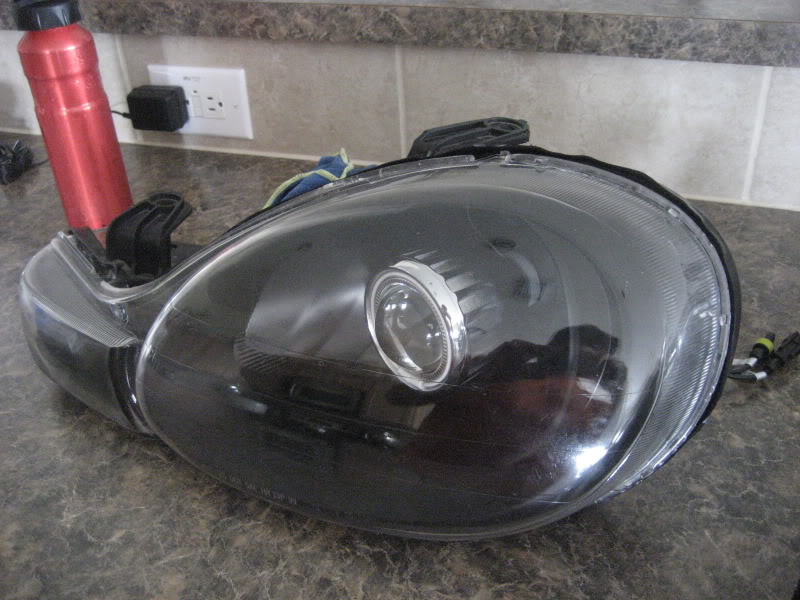

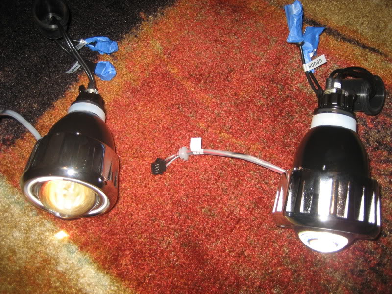

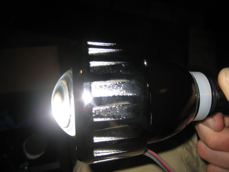

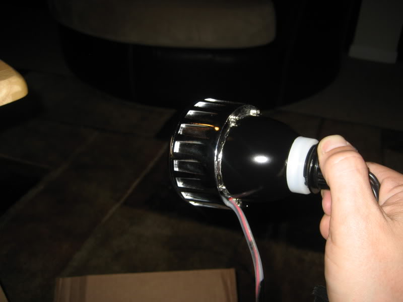

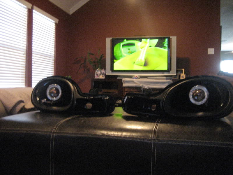

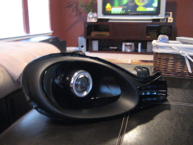

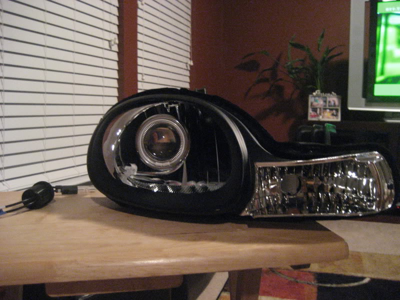

Here is what I did so far.... I"m still trying to figure out if I want to use the halos or not....
one of my dogs.. Alex checking things out..lol
test mounted
and the two side by side...

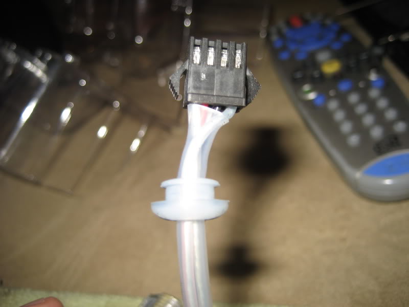

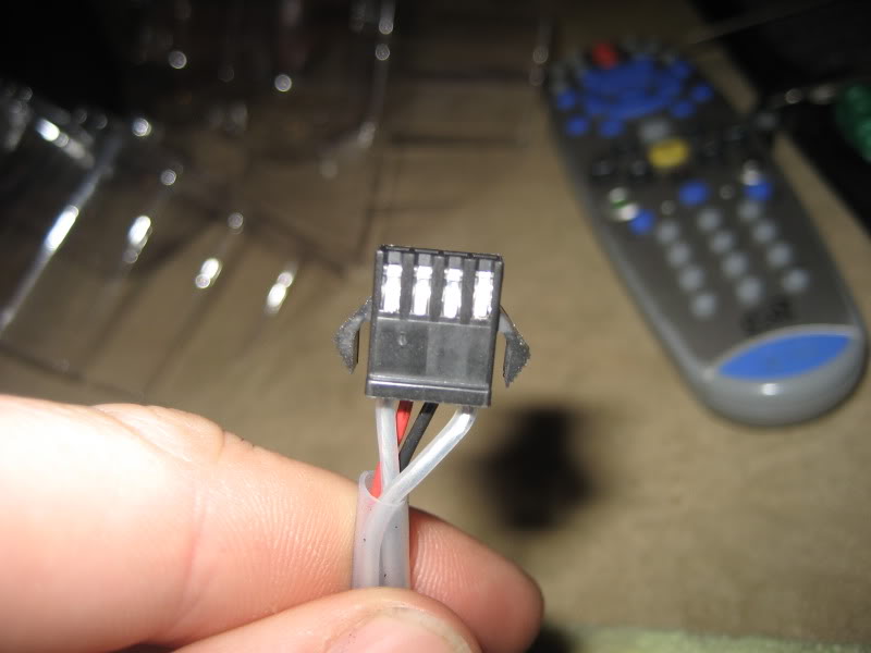

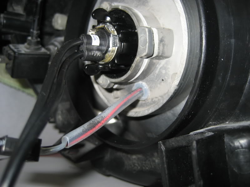

My issue right now is this....
the plug is bigger then the plug...
Well I figured how to fix the plug issue.. I just had to de-pin it , drill the hole and seal it.
edit again..
I finished up the halo grommets and now I just need to power them up and make sure they aim correctly before I seal them up.

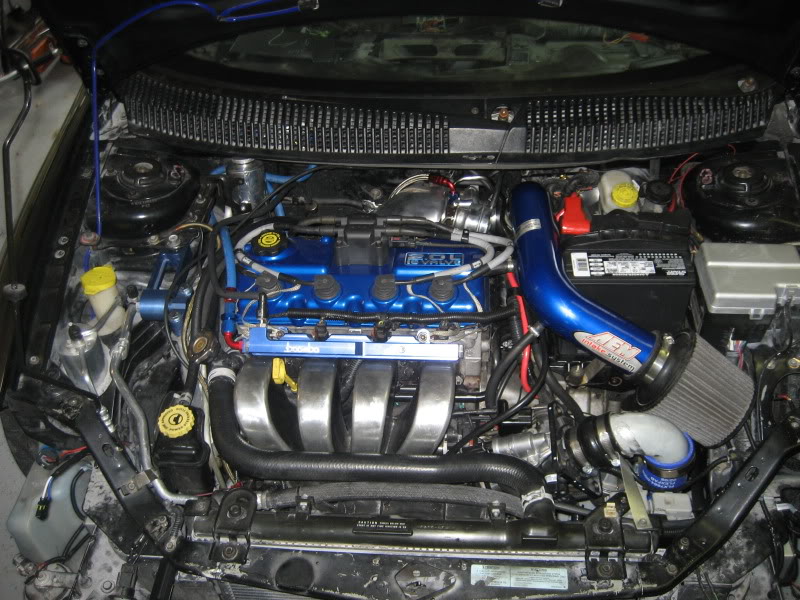

Well Matt and I were able to seal up the vac and boost lines to give it a test drive down the road..
The Mopar battery is dead... so I'll have to get another battery this week. I still need to pick a couple of small things to finalize the build until it arrives back at my house to finish up the headlights, and mount the bumpers etc....
We weren't getting any boost, due to my mistake on not clipping the wastegate to the manifold..

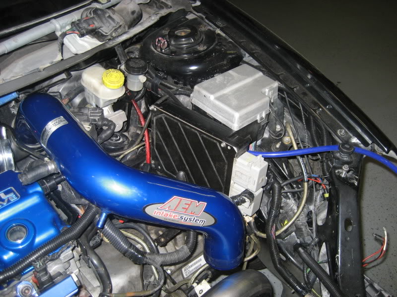

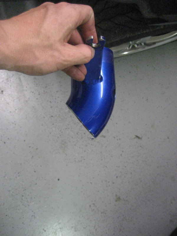

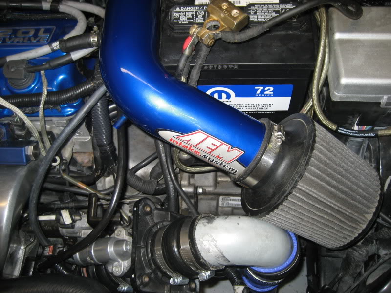

We also looked at modifying the Short ram intake to fir better..
A close fit, but much better...
Farther pic away, and this is what we cut off to make it fit.
taped up.
Primer on...
not bad....

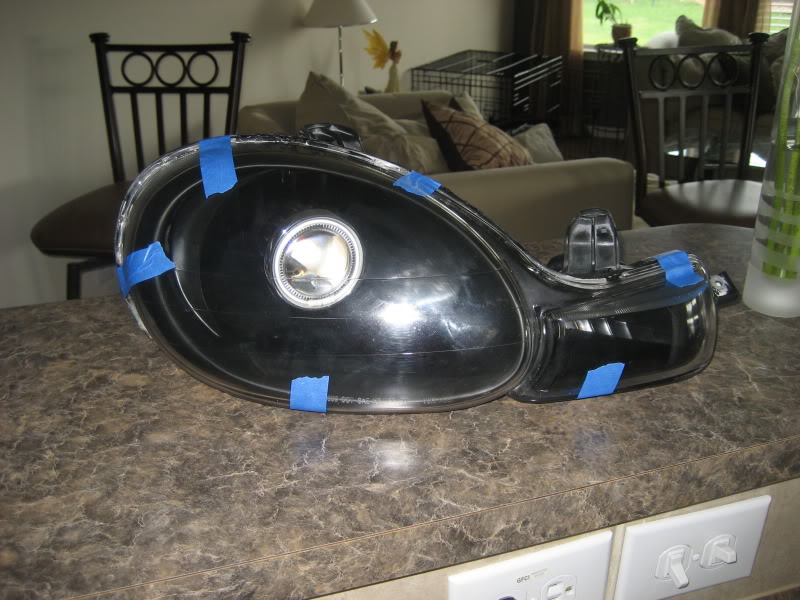

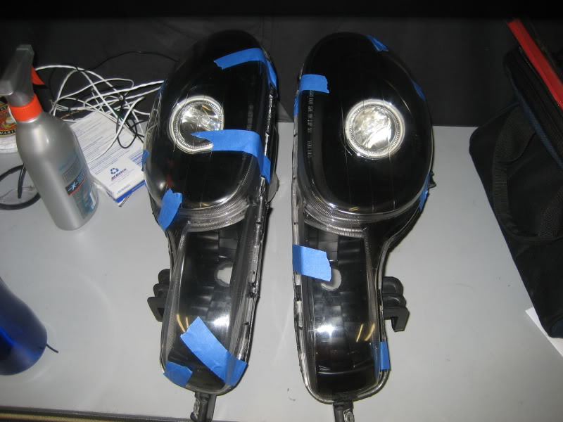

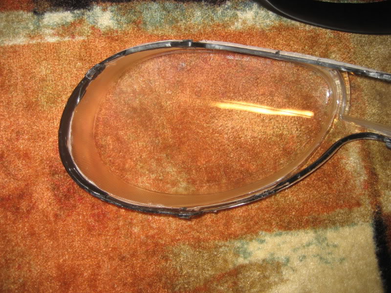

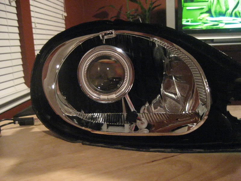

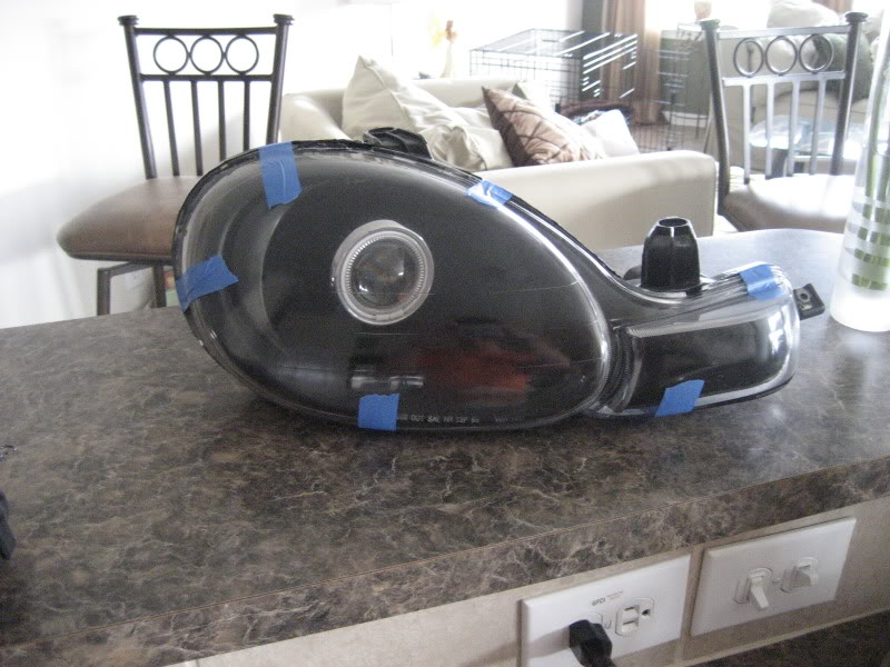

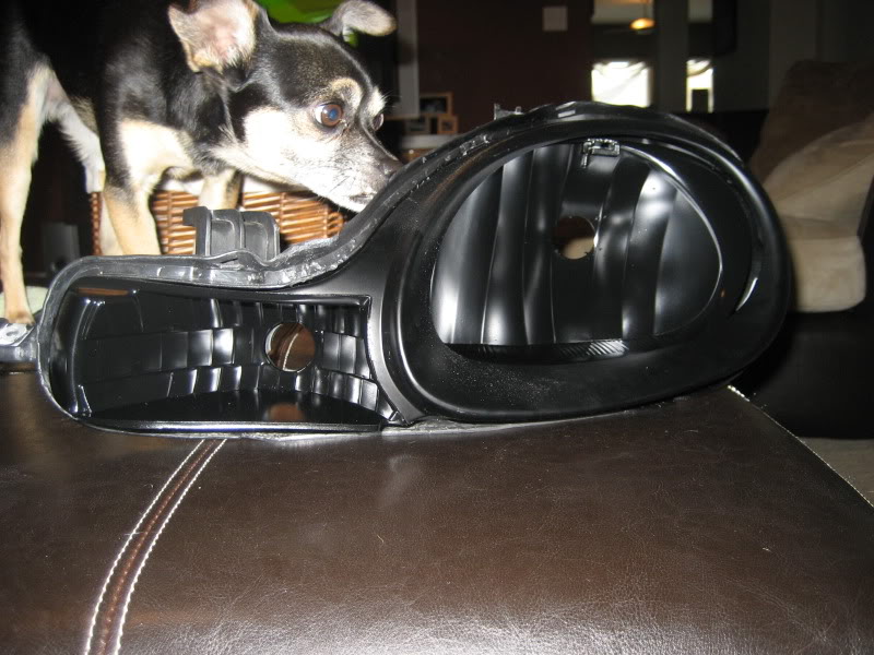

I did do a little today... I went ahead and cleaned up the headlights today mocked up the fitment...
Worked with a heat gun to re-form the plastic housings for the sealer..
Mocked up and looking good...

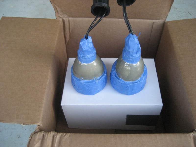

I then went ahead and used the window sealer ( windshield sealer from 3M) and heated up the edges to close up the pastic a bit more.
Finished the other side and taped up for the night. THen I will try to see what it looks like tomorrow after work.. Hopefully they seal right.
